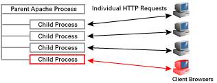

When a client such as a Web browser connects to a Web site served by Apache, a process is dispatched to handle that request. In Apache 1.3.x, each of these processes (called "child" processes) are mutually independent. That is to say, unlike a thread-based model, each process has a completely independent memory and execution space in the server. This approach has long been considered a benefit to Apache because it makes the entire server incredibly stable—if a particular request causes Apache to crash, it will be far more likely to crash only the particular, individual child that handled the request.
This process is illustrated in Figure 1, where red indicates a segmentation fault caused by a particular HTTP request.
Figure 1 Segmentation fault in action
While this architecture is clearly a benefit for ensuring a stable Web server environment, the side effect of this "sandboxing" of each individual HTTP request is that everything regarding the request is by necessity also isolated from other requests. Because most PHP setups (by recommendation) are done running PHP as a module within Apache (mod_php), PHP scripts running in this pre-fork model themselves are subject to the same mutual isolation of requests. Thus, all variables and resources available within PHP are allocated and destroyed within the context of a single Apache child—and this is where persistent Oracle connections start coming into play.

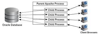

Because all PHP resources are defined within the context of a single Apache child, when PHP establishes a database connection to an Oracle database the only place that connection exists is within that specific child. Thus, when a executing the same PHP script that makes a database connection concurrently for multiple different clients, each child must establish its own connection. (See Figure 2.)
Figure 1 Concurrent database connections across multiple clients
If each child process is executing the same PHP script, you can imagine the inefficiencies the pre-fork Apache model imposes on PHP as well as Oracle, as theoretically only one database connection was needed for all four children. Furthermore, even with four individual connections to the database using the standard connection methods provided by the Oracle APIs for PHP, this connection is broken and re-established for every single request. Even if each child must have its own connection, re-establishing the connection every request seems quite unnecessary for the vast majority of cases—and thus PHP attempts to address this issue through the notion of persistent database connections. This approach, unfortunately, only solves part of the problem—while persistent connections prevent the connection from being broken on every request, the PHP resource that is persisted across requests still only exists within a single child.
(Hint: If you are curious about how many total connections can occur to your Oracle database, take a look at the MaxClients configuration directive in your Apache Web server. Assuming your PHP scripts make X connections to your database per request, Oracle should be prepared to accept MaxClients * X database connections under peak load.)
