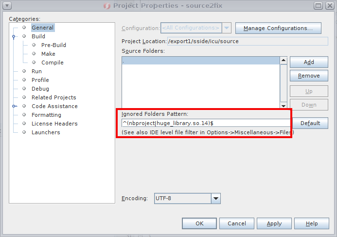

If you prefer not to recreate the project, you can also omit the library after creating the project. To do this, right-click the project in the Projects window, select Properties, click the General node, and then add the library name to the Ignored Folders Pattern field, which is highlighted in Figure 7.
Picture of Project Properties dialog box and Ignored Folders Pattern field
Figure 7. Ignored Folders Pattern Field
The Ignored Folders Pattern format is ^(dirname|dirname|dirname)$. Figure 7 shows ^(nbproject|huge_library.so.14)$, which causes the IDE's project folder and the huge_library.so.14 folder to be omitted from the project.
