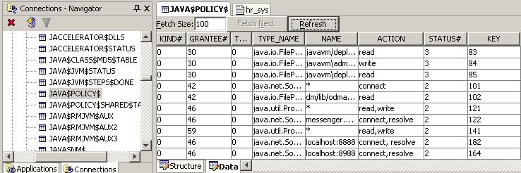

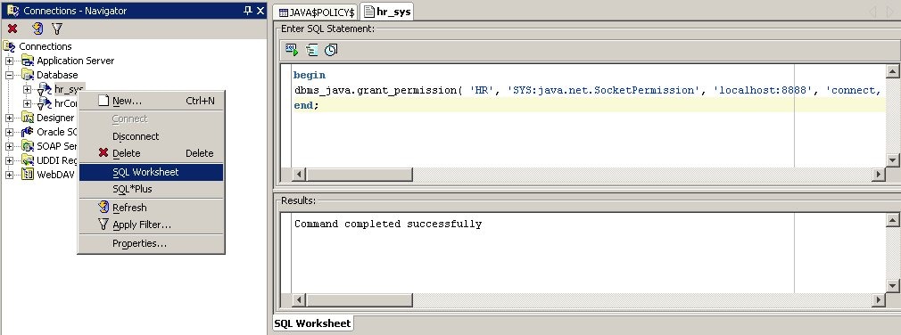

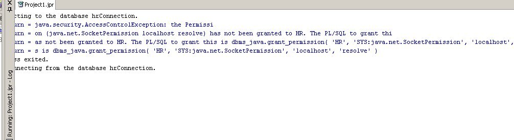

Your schema needs the correct Java 2 Permissions. See Chapter9 (Security) of the Database Java Developer's Guide for a detailed explanation. You can check whether the correct permissions already exist using the table browser (see step 4). The example in this HowTo uses the HR schema, you might set the permissions as follows.
dbms_java.grant_permission('HR','SYS:java.util.PropertyPermission','*','read,write') dbms_java.grant_permission( 'HR', 'SYS:java.lang.RuntimePermission', 'getClassLoader', '' )To disable a permission you can use dbms_java.disable_permission(164) where '164' is the Key column from the table (see above example). To permanently delete a permission first disable and then delete dbms_java.delete_permission(164)

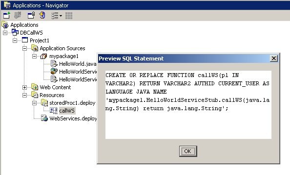

public static String callWS(String s) { HelloWorldServiceStub stub = new HelloWorldServiceStub(); try { String result= stub.sayHello(s); return result; } catch (Exception ex) { String error = ex.toString(); return error; } }

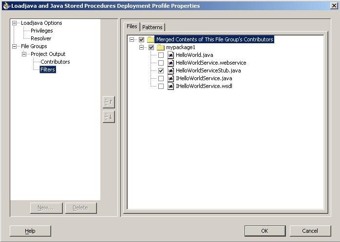

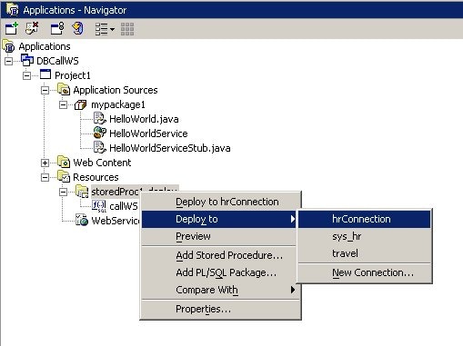

Create a deployment profile to load the calling classes into the database

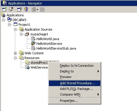

Use the context menu of your deployment profile to deploy the profile and the callWS function to your database

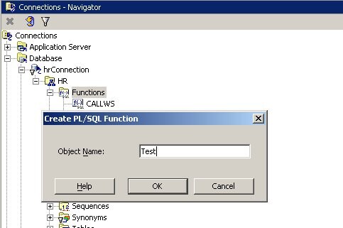

FUNCTION "TEST" RETURN VARCHAR2 AS mystring varchar2(2000); BEGIN mystring := HR.CALLWS(' tester'); RETURN(mystring); END;

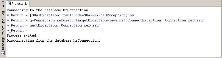

Problem | Possible Solution |
ORA-29541: class HR.mypackage/MyHelloStub could not be resolved
ORA-06512: at "HR.CALLWS", line 0 ORA-06512: at "HR.TEST", line 6 ORA-06512: at line 5 Process exited. Disconnecting from the database hr16179. |
SOAP stack not loaded |
Ensure that the OC4J instance where your web service is deployed is up and running with your web and that the stub reflects that in its endpoint
Check that your database schema has all necessary permissions granted. See Grant Java Permissions to HR Schema |
