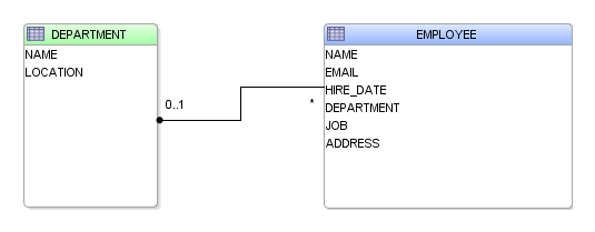

You'll edit the HR Application schema to add two new fields, Job and Address, to the Employee business object as shown in the following diagram.
HR Schema Diagram
Description of this image

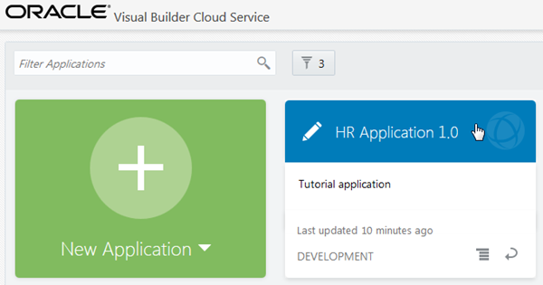

  1. In the web browser, log in to Oracle Visual Builder Cloud Service.
  2. On the Home page, click HR Application 1.0.
    Home page

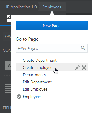

  3. In the Page Designer, open the page menu and select Create Employee.
    Page menu

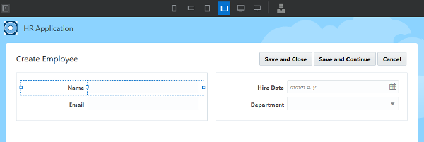

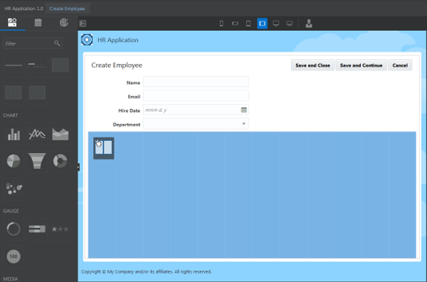

  4. From the Components palette, drag and drop the Two-Column Layout component onto the Create Employee page below the Department field.

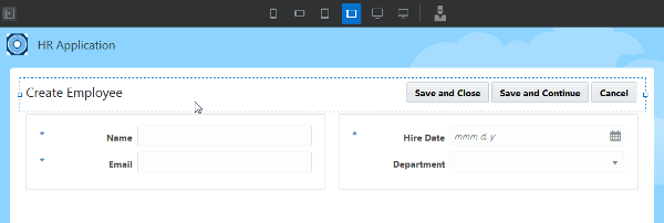

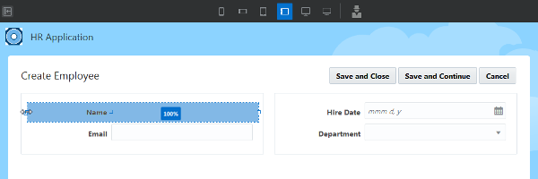

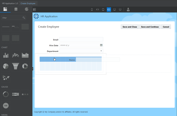

  5. Drag and drop the Name field of the Create Employee page into the left column of the Two-Column Layout component.

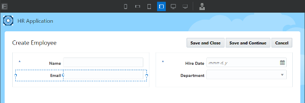

  6. Similarly, drag and drop the other fields of the page into the left and right columns of the Two-Column Layout component. Move the Email field to the left column, and move the Hire Date and Department fields to the right column.
  7. If necessary, drag the left and right widths of the fields to adjust their widths to 100%.

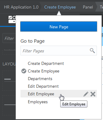

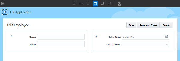

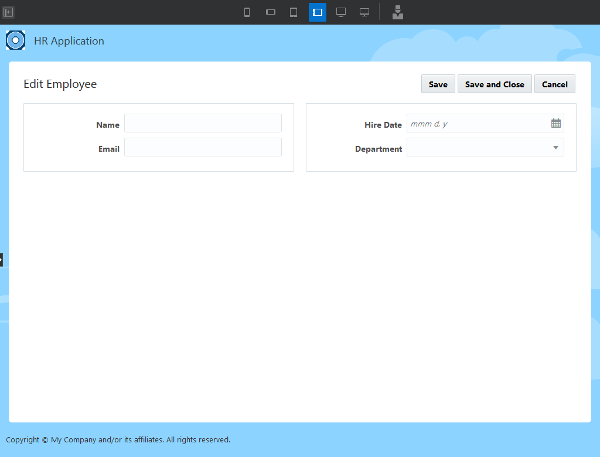

  8. Open the page menu and click Edit Employee.
    Page menu
  9. Drag and drop the Two-Column Layout component onto the Edit Employee page and arrange the fields the same way you did for the Create Employee page.
    Edit Employee page

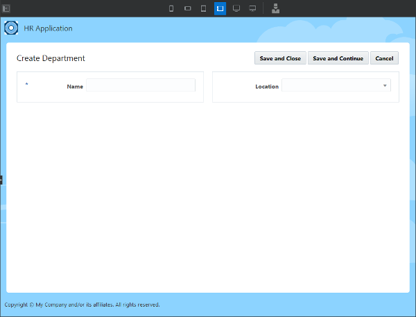

  10. Open the page menu and select the Create Department page.
  11. Drag and drop a Two-Column Layout component onto the page. Move the Name field to the left column, and move the Location field to the right column.

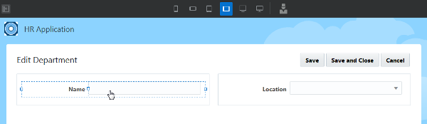

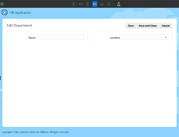

  12. Open the page menu and select the Edit Department page.
  13. Drag and drop a Two-Column Layout component onto the page and arrange the fields the same way you did for the Create Department page.

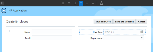

  1. Open the page menu and select the Create Employee page.

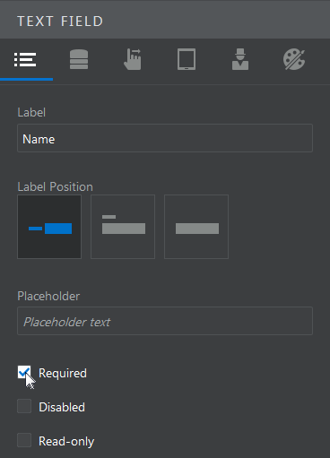

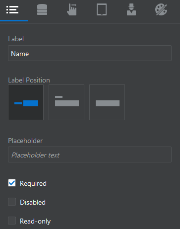

  2. Select the Name field.
  3. For a text field, the Property Inspector provides six tabs: Properties, Data, Actions, Responsive, Roles, and Style. Some components have fewer tabs. In the Properties pane, select the Required check box.
    Text Field Property Inspector
    After you select the Required check box, an asterisk appears before the Name field.

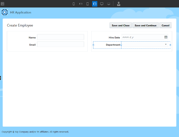

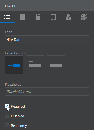

  4. Select the Hire Date field.
  5. In the Properties tab of the Hire Date properties pane, select the Required check box.
    Date Property Inspector

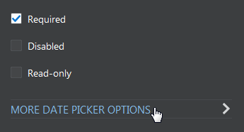

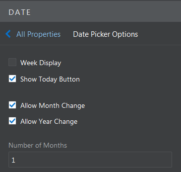

  6. Click More Date Picker Options.
    Date Picker Options in Date Property Inspector
  7. Select the Show Today Button, Allow Month Change, and Allow Year Change check boxes.

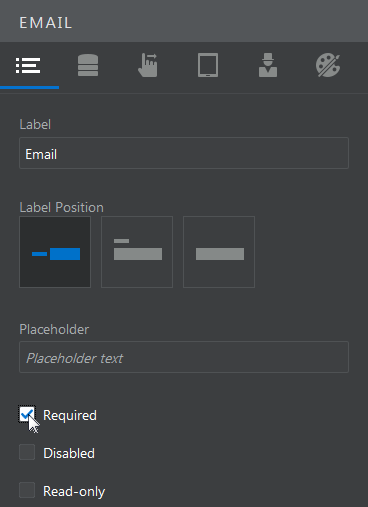

  8. Select the Email field.
  9. In the Properties pane, select the Required check box.
    Email Property Inspector
    After you select the Required check box, an asterisk appears before the Email field.

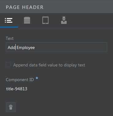

  11. In Page Header Properties, change the Text value to Add Employee.
    Page Header Property Inspector
    When you update the Text value of the Page Header, you edit the title of the page. The page name in the page menu and other places will remain Create Employee.

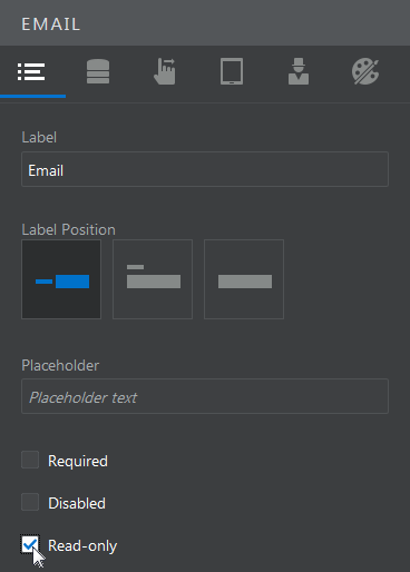

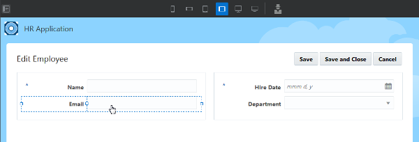

  14. Select the Email field.
    Edit Employee page
  15. In the Email Properties pane, select the Read-only check box.
    Typically, an email address once assigned to an employee is not changed.

  17. Select the Name field.
  18. In the Text Field Properties pane, select the Required check box.
    You already configured the Name field of the Create Department page as Required in the Getting Started with Oracle Visual Builder Cloud Service tutorial.

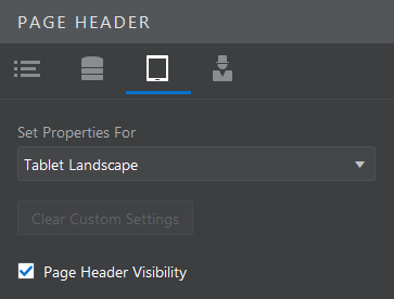

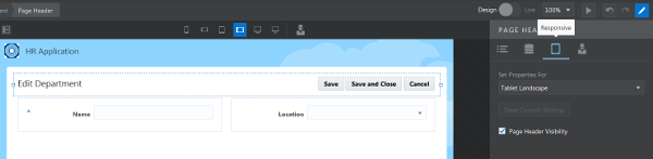

  19. Click the page header, then click the Responsive tab.
    Responsive tab
  20. For a page header, the only responsive property you can set for the device canvas areas is whether the component is visible or not. Click the two fields on the page and verify that visibility is the only available component for them, too.
    Responsive tab for Text Field

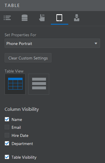

  22. Click in the table and view the Responsive properties for the Table component. You can change the table from a standard view to a row view. You can change the visibility of each column and of the table as a whole.
    Responsive tab for Table
  23. Select Phone Portrait from the Set Properties For drop-down list and notice that most columns are not visible in the canvas area. Deselect the Email and Hire Date options so that only the Name and Department columns are displayed.
    Responsive tab for Phone Portrait

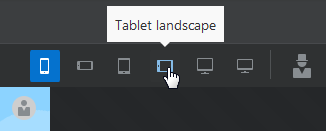

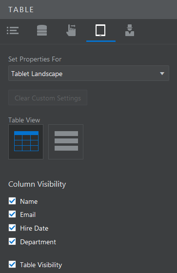

  24. Click Tablet landscape to return to the canvas view you were using. All the columns are visible again.
    Tablet Landscape tab

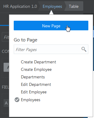

  1. Open the page menu and click New Page.
    Page menu

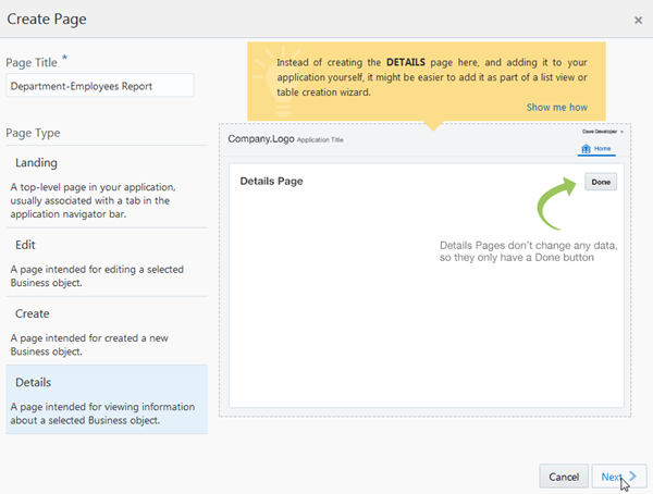

  2. On the first page of the Create Page wizard, enter the following:
    • Page Title: Department-Employees Report
    • Page Type: Details
    Create Page wizard
    Click Next.

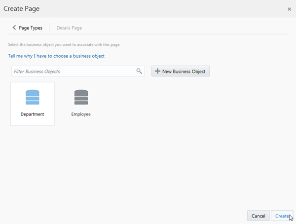

  3. Select Department as the page's associated business object.
    Create Page wizard
  4. Click Create.

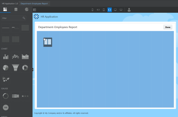

  5. In the Department-Employees Report page, open the Components palette if it is not already open.
    Components palette
  6. Drag and drop a Two-Column Layout component onto the report page.

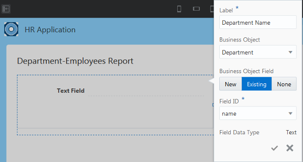

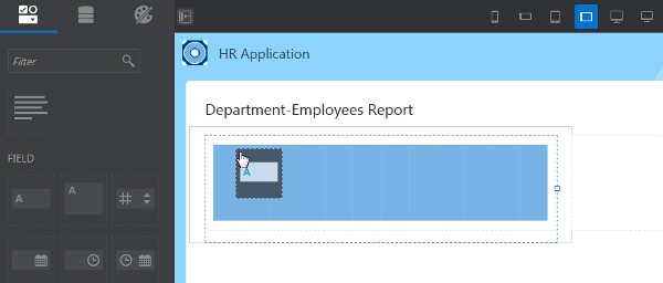

  7. Drag a Text Field component and drop it into the left column of the Two-Column Layout component.
  8. In the pop-up box, enter the following:
    • Business Object Field: Click the Existing toggle button
    • Business Object: Department (automatically populated)
    • Field ID: Select name from the drop-down list
    • Label: Update to Department Name
    Text Field pop-up box
    Click the OK icon to save the details.

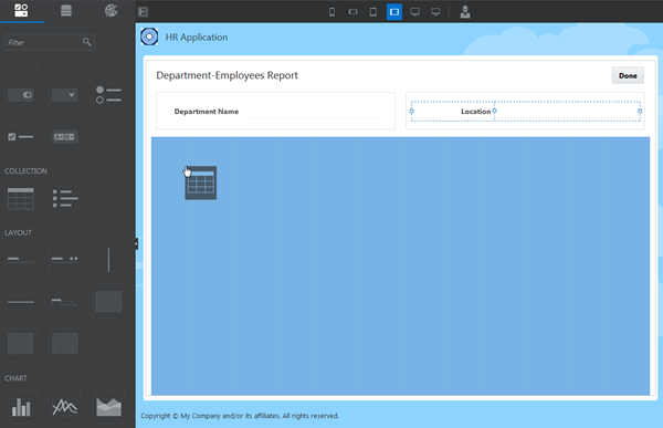

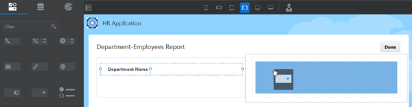

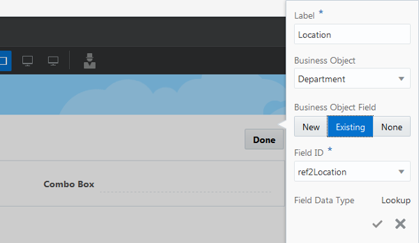

  9. Drag a Combo Box component and drop it into the right column of the Two-Column Layout component.
  10. In the pop-up box, enter the following:
    • Label: Location (automatically populated)
    • Field ID: ref2Location (automatically populated)
    Combo Box pop-up box

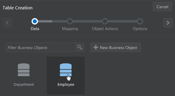

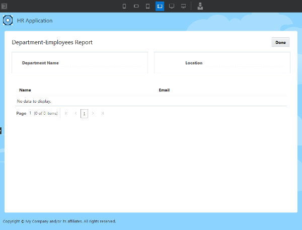

  11. Drag and drop a Table component onto the report page below the Two-Column Layout component.
  12. In the Data page of the Table Creation wizard, select Employee.
    Data page of Table Creation wizard

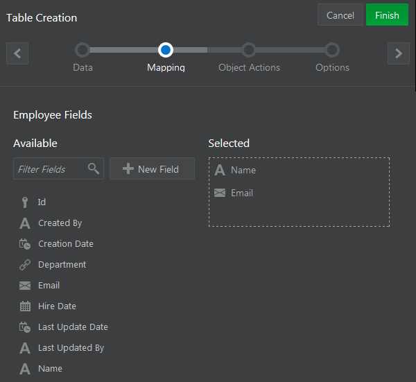

  13. In the Mapping Page, drag and drop the Name and Email fields into the Selected area and click Next.
    Mapping page of Table Creation wizard

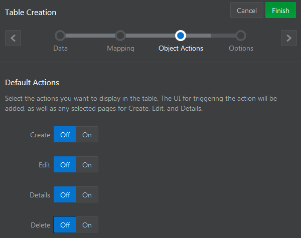

  14. In the Object Actions page, click Off for all default actions (Create, Edit, Delete, and Details) and click Next.
    Object Actions page of Table Creation wizard

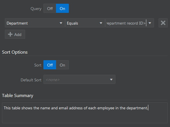

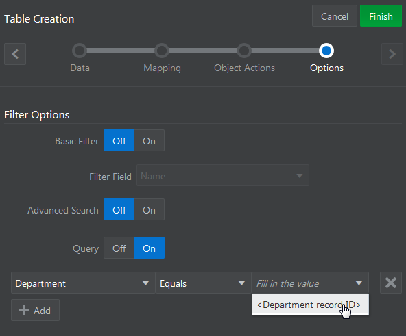

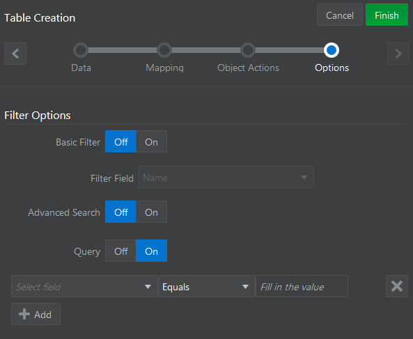

  15. In the Options page, click the On toggle button of Query.
    Options page of Table Creation wizard
  16. In the first list, select Department. In the third list, select <Department record ID>. If an error message appears, you can safely ignore it.
  17. In the Table Summary field, enter text like this:
    This table shows the name and email address of each employee in the department.
  18. Click Finish.
    The Department-Employees Report page should look like this.

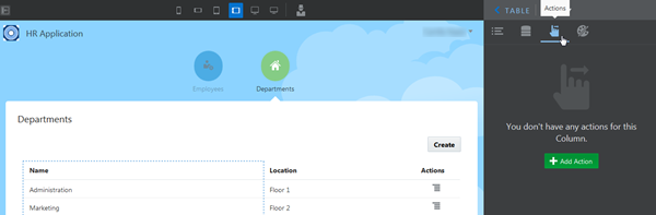

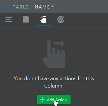

  20. Click the Name column of the Departments table and click the Actions tab in the Table Properties pane.
    Departments page and Actions tab

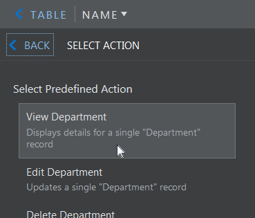

  21. In the Actions tab, click + Add Action.
    Actions tab of Table Property Inspector
  22. Click the predefined action View Department.
    In Live mode or in Test Application mode, clicking the Name column link in the Departments page will open the Department-Employees Report page that will list all employees of the selected department.

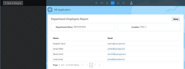

  23. Click the Test Application button in the toolbar.
  24. In the Departments page, click a department Name link to view all employees of the selected department.
    Click Back to Designer to return to the Page Designer.
