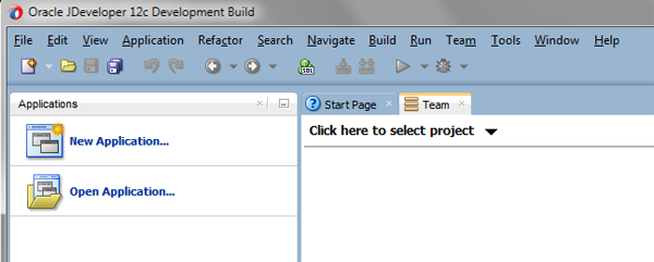

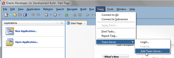

  1. Open JDeveloper.
  2. From the Team menu, click Team Server, and then click Add Team Server.
    Description of this image

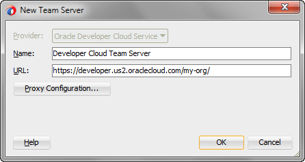

  3. In the New Team Server dialog, enter the following information:
    • Name: Enter Developer Cloud Team Server
    • URL: Enter the URL of your organization on the Oracle Developer Cloud Service instance
      Example: https://developer.us2.oraclecloud.com/my-org/
      Oracle Developer Cloud Service is the default provider of the Team Server. If necessary, click Proxy Configuration to configure the proxy settings.
  4. Click OK.
    The Team tab is now available in JDeveloper.

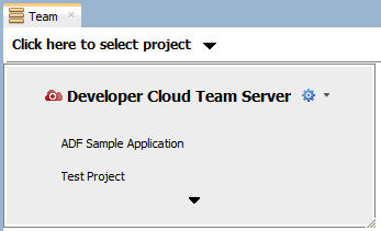

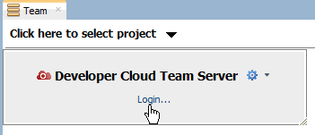

  5. In the Team tab, click Click here to select project.
  6. In the Developer Cloud Team Server list, click Login.

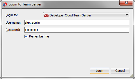

  7. In the Login to Team Server dialog, enter the following information:
    • Username: Enter your Oracle Developer Cloud Service instance user name
    • Password: Enter your Oracle Developer Cloud Service instance password
  8. Click Login.

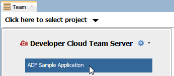

  1. In the Developer Cloud Team Server project list, click ADF Sample Application.

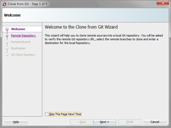

  4. In the Welcome page of the Clone from Git wizard, click Next.

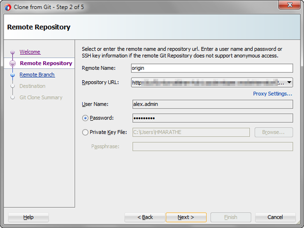

  5. In the Remote Repository page, click Next.
    The wizard picks the values for Repository URL, Username, and Password from the Team Server. If you prefer to use SSH, update the values of Repository URL and Private Key File before clicking Next.

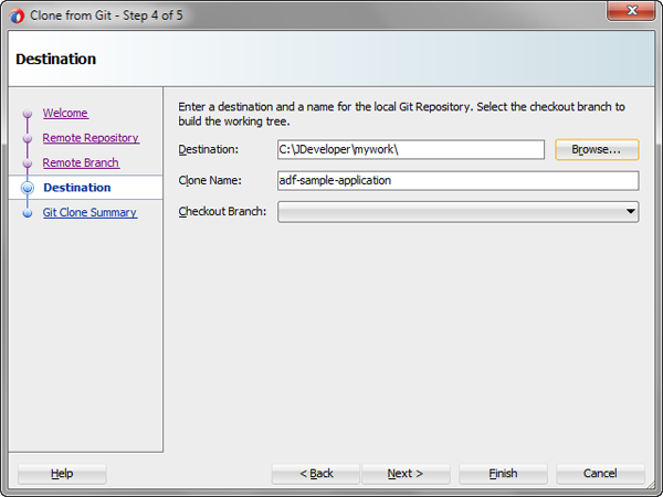

  7. In the Destination page, if necessary, update the following information:
    • Destination: The path of the directory where you want to clone the Git repository
    • Clone Name: The name of the cloned Git repository directory
    The Checkout Branch drop-down list is expected to be empty.
  8. Click Next.

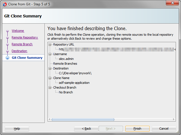

  9. In the Git Clone Summary page, click Finish.

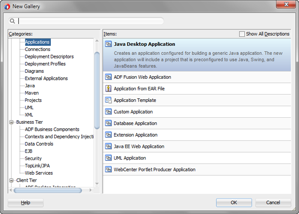

  10. In the New Gallery dialog, click Cancel to close the dialog.
    You will not create an application, but add the Oracle Alta UI Work Better Application to the cloned Git repository directory.

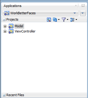

  2. In JDeveloper, open the WorkBetterFaces application.

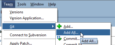

  3. From the Team menu, select Git, and then select Add All.
  4. In the Add All dialog, click OK.
    After all files are added to the staging index, notice the icons in the Applications window have changed to show a + icon in the lower left corner.

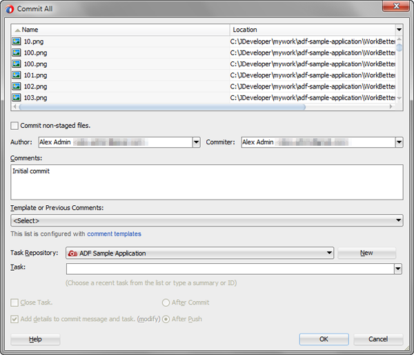

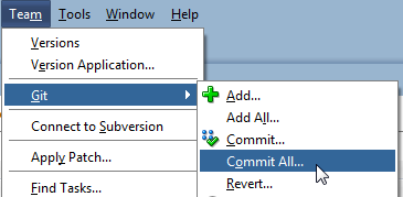

  5. From the Team menu, select Git, and then select Commit All.
  6. In the Commit All dialog, enter a comment in Comments.
    If necessary, specify your name and email address in the Author and Commiter fields in the Name <email> format.
  7. Click OK.

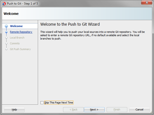

  8. From the Team menu, select Git, and then select Push.
  9. In the Welcome page of the Push to Git wizard, click Next.

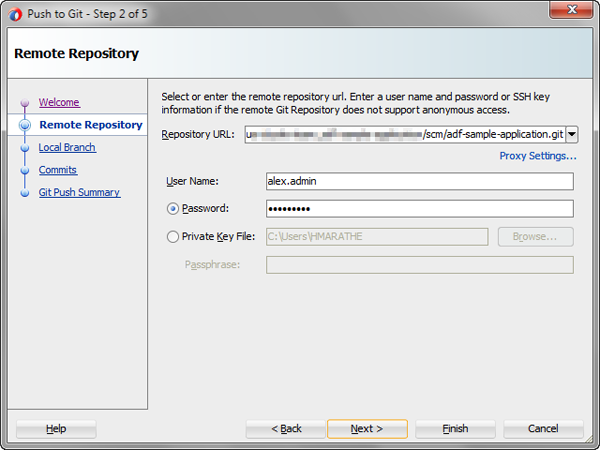

  10. In the Remote Repository page, click Next.

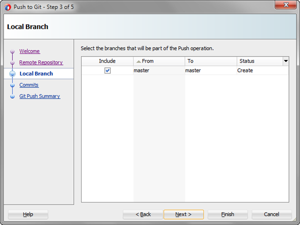

  11. In the Local Branch page, click Next.
    The master branch was created when you committed the application files.

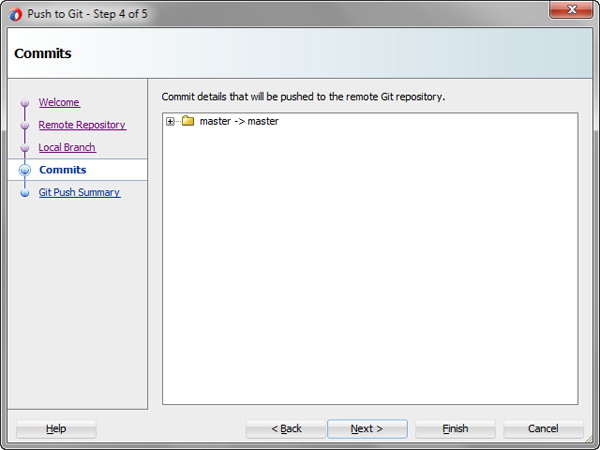

  12. In the Commits page, click Next.

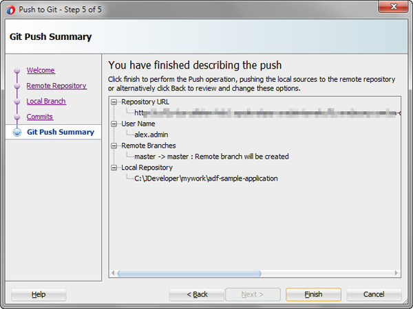

  13. In the Git Push Summary page, click Finish.
    A Git Push progress bar appears in the Status bar of JDeveloper. Wait for JDeveloper to push all files to the project Git repository.

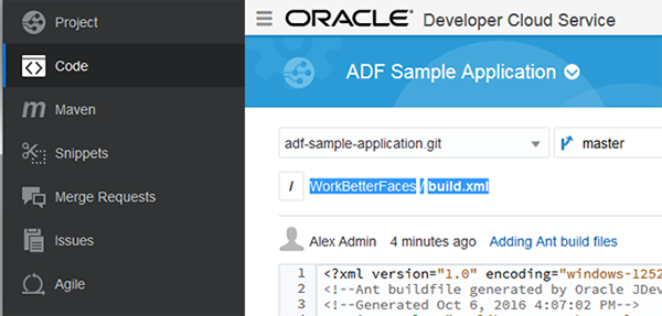

    After the Git Push is complete, open the project in Oracle Developer Cloud Service web interface and verify the commit in the Project page.

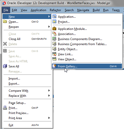

  1. In JDeveloper, open the WorkBetterFaces application, if you closed it.
  2. From the File menu, click New, and then click From Gallery.
  3. In the New Gallery dialog, select Ant in the General Category, and then select Buildfile from Application in the Items list.
  4. Click OK.

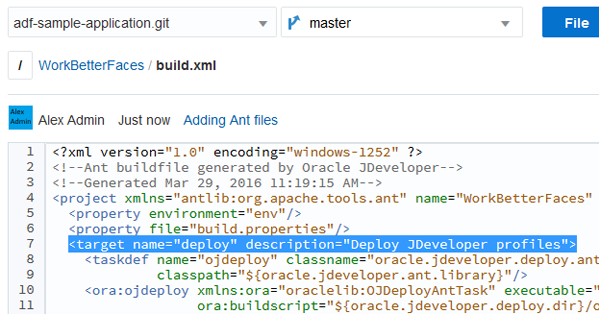

    Two new files, build.xml and build.properties, are added to the ADF application.
Configuring the Ant Buildfiles

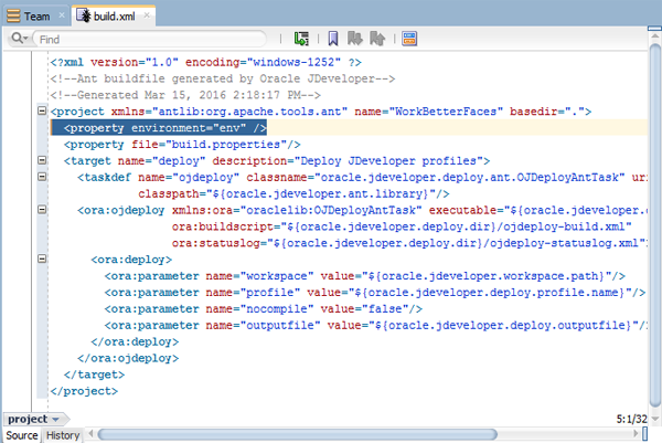

  1. Double-click build.xml to open it in the code editor.
  2. Add the following code line before <property file="build.properties"/>:
    <property environment="env"/>
    The <property environment="env"/> code in build.xml enables Ant to access the system environment variables and store them in properties, prefixed with env.
  3. Save build.xml.

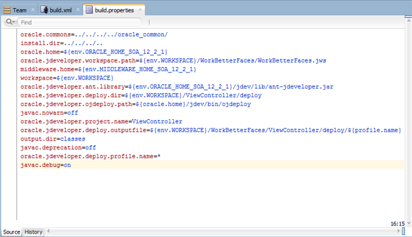

  4. Double-click build.properties to open it in the code editor.
  5. Remove the existing code of build.properties and add the following code to it.
    oracle.commons=../../../../oracle_common/
    install.dir=../../../..
    oracle.home=${env.ORACLE_HOME_SOA_12_2_1}
    oracle.jdeveloper.workspace.path=${env.WORKSPACE}/WorkBetterFaces/WorkBetterFaces.jws
    middleware.home=${env.MIDDLEWARE_HOME_SOA_12_2_1}
    workspace=${env.WORKSPACE}
    oracle.jdeveloper.ant.library=${env.ORACLE_HOME_SOA_12_2_1}/jdev/lib/ant-jdeveloper.jar
    oracle.jdeveloper.deploy.dir=${env.WORKSPACE}/ViewController/deploy
    oracle.jdeveloper.ojdeploy.path=${oracle.home}/jdev/bin/ojdeploy
    javac.nowarn=off
    oracle.jdeveloper.project.name=ViewController
    oracle.jdeveloper.deploy.outputfile=${env.WORKSPACE}/WorkBetterFaces/ViewController/deploy/${profile.name}
    output.dir=classes
    javac.deprecation=off
    oracle.jdeveloper.deploy.profile.name=*
    javac.debug=on
    In the above code, you are configuring Ant to use the Oracle Developer Cloud Service environment variables.
    • oracle.home uses the ORACLE_HOME_SOA_12_2_1 environment variable to define the path of the JDeveloper 12.2.1 directory installed on the Oracle Developer Cloud Service Hudson executor.
    • middleware.home uses the MIDDLEWARE_HOME_SOA_12_2_1 environment variable to define the path of the Oracle Fusion Middleware directory installed on the Oracle Developer Cloud Service Hudson executor.
    • oracle.jdeveloper.ant.library defines the path of the Ant library on the Oracle Developer Cloud Service Hudson executor
    • oracle.jdeveloper.ojdeploy.path defines the path of OJDeploy on the Oracle Developer Cloud Service Hudson executor
    • oracle.jdeveloper.deploy.outputfile defines the path of the output file
    • oracle.jdeveloper.deploy.dir defines the path of the deployed artifacts directory
    To learn more about Oracle Developer Cloud Service environment variables on the Hudson executor, see the Using Hudson Environment Variables reference in the Want to Learn More section.
    Make sure there are no spaces at the end of each property definition.

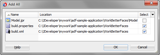

  1. From the Team menu, select Git, and then select Add All.
  2. In the Add All dialog, click OK.
    Note: When you add Ant buildfiles to your application in JDeveloper, the selected project in the Applications window is also updated and appears in the file list of the Add All dialog. Before you click OK, you may choose to ignore the update to the project .jpr file. To ignore the update, deselect the Select check box on the right of the file row.

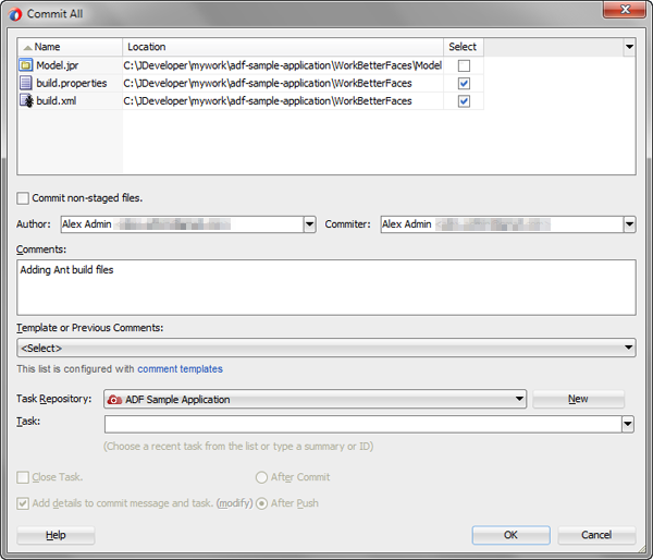

  3. From the Team menu, select Git, and then select Commit All.
  4. In the Commit All dialog, enter the commit comment in Comments.
    Note: You may choose to ignore the update to the project .jpr file. To ignore the update, deselect the Select check box on the right of the file row.
  5. Click OK.

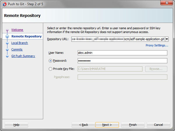

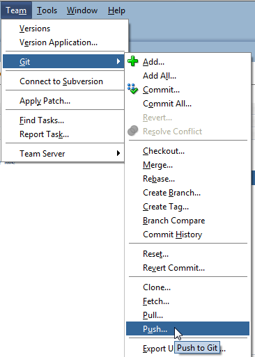

  6. From the Team menu, select Git, and then select Push.
  7. In the Welcome page of the Push to Git wizard, click Next.
  8. In the Remote Repository page, click Finish.
You do not need to go through all pages of the Push to Git wizard. Wait for JDeveloper to push all files to the project Git repository. After the Git Push is complete, verify the added files in the Code page.

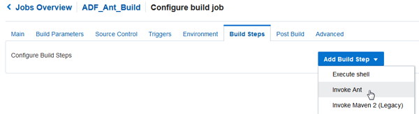

Creating and Configuring a Build Job in Oracle Developer Cloud Service
In this section you will learn how to configure an Oracle Developer Cloud Service build job to run Ant and deploy the artifacts to the Ant deploy directory.

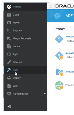

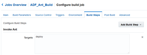

  1. In Oracle Developer Cloud Service web interface, open your project and click Build in the navigation bar.
  2. In the Jobs Overview page, click New Job.
  3. In the New Job dialog, enter ADF_Ant_Build as the Job Name and click Save.
  4. In the Main tab of the Configure build job page, select JDK 8in JDK.
    ADF 12c (12.2.1.0.0) applications require JDK 8.

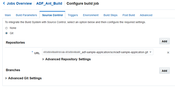

  5. Click the Source Control tab and select the Git option.
  6. In the Repositories section, select the Git repository URL of adf-sample-application.git.

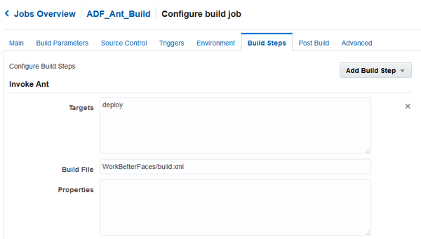

  8. In the Build Steps tab, click Add Build Step and select Invoke Ant.
  9. In the Targets field, enter deploy.
    JDeveloper created a default deploy target when you added build.xml to the WorkBetterFaces application.
    If you have modified the target name, make sure that the Targets value must match the value of the name attribute of the <target> element specified in build.xml.
  10. In the Build File field, specify the path of build.xml.
    You can find the path of the file in the Code page.

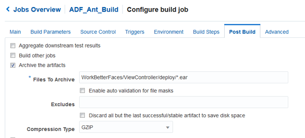

  11. Click the Post Build tab.
  12. In the Post Build tab, select the Archive the Artifacts check box, and enter WorkBetterFaces/ViewController/deploy/*.ear in Files to Archive.
    Remember you specified the path of the output file in the oracle.jdeveloper.deploy.outputfile property of the build.properties file.
  13. Click Save.

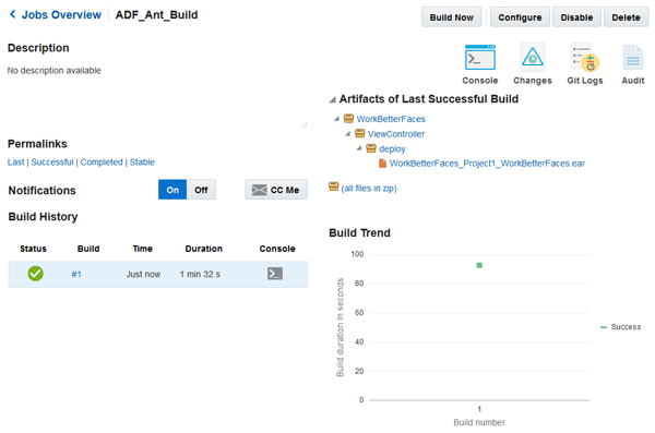

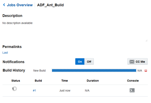

  14. In the ADF_Ant_Build details page, click Build Now.
  15. Wait for the build to complete.
  16. After the build has run, expand Artifacts of the Last Build to view the archived artifacts.
    Click WorkBetterFaces_Project1_WorkBetterFaces.ear to download the EAR file to your local computer, which you may deploy to your preferred web server.

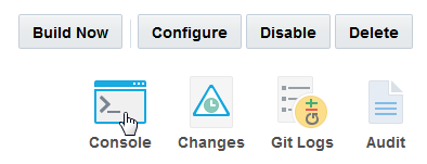

    Click the Console icon to view the build console. You may want to do that in case of a build failure.

    You can also see the build's status in JDeveloper. In the Team Server tab, expand Builds to see the build status of ADF_Ant_Build.
    You might have to refresh the project in Team Server. Mouse over the project name ADF Sample Application and click the Refresh icon.
