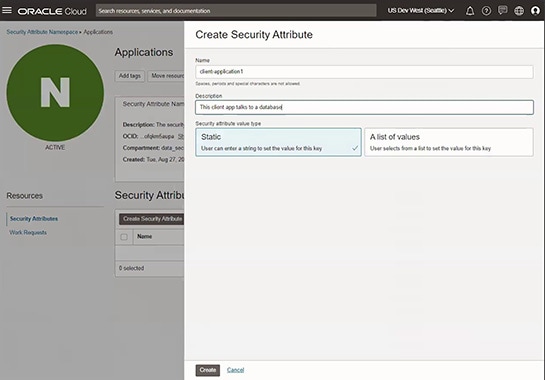

When you enable OCI ZPR, it creates a security attribute namespace in the tenancy called “Oracle-zpr” that includes an example security attribute named “Sensitivity.” You can use this default namespace or create additional namespaces by selecting “Security Attribute Namespace” from the ZPR menu, then selecting “Create Security Attribute Namespace.” You can use the filters on the landing page to list the namespaces in your tenancy.
Select the appropriate namespace and click the “Create Security Attribute” button to add new security attributes.

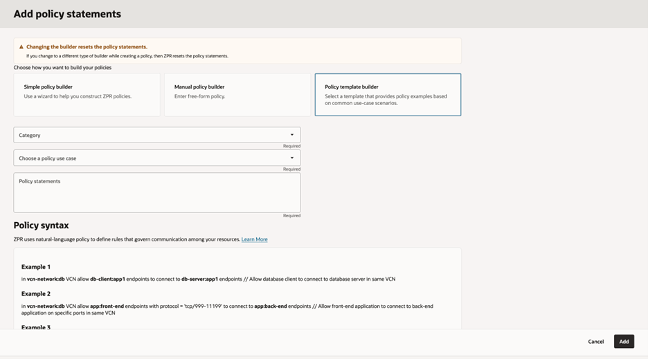

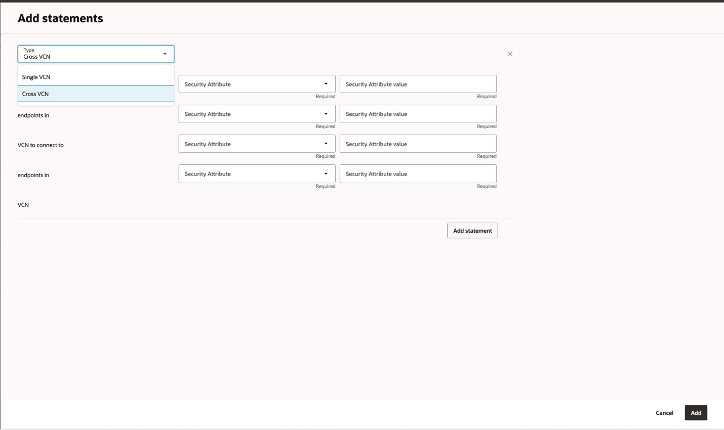

To create OCI ZPR policy, select “Policies” from the left-hand ZPR menu, then click “Create policy.” The landing page lists the existing policies in your tenancy.
To write the OCI ZPR policies, you can use one of the following options.
