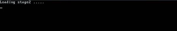

If the system appears to be booting from the hard disk and the Solaris OS installer does not start, power cycle the system (power cycle is shutting down the power on the system and then restarting the system). As the system begins to boot, enter setup mode. Typically, the system displays a message indicating which key to press (such as "Enter F2 to enter setup", although the key to press varies by manufacturer; the ESC and F12 keys are other common options.) If you miss the message, simply restart the system a couple of times until you are able to view it.
Once in setup mode, specify the boot device for the system. This example specifies the CD or DVD drive as the boot device. To do so, find the list that describes boot order and re-order as needed to ensure the CD or DVD drive appears first on the list. The system should then boot from the CD or DVD drive to start the install process.

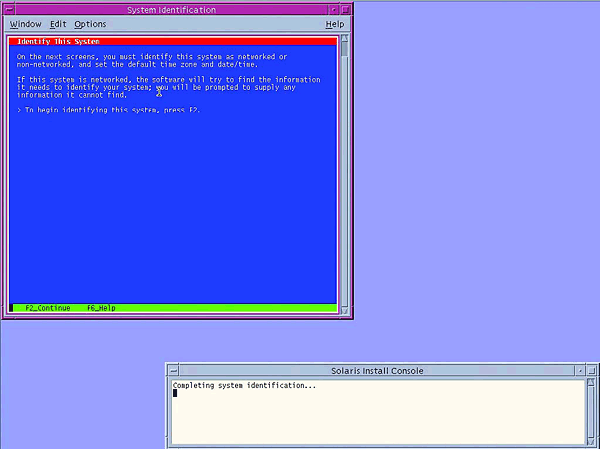

    A new window, the Solaris Install Console, appears in the bottom-right corner. This window is used to display pertinent installation messages. Another window appears in which the Solaris OS installation questions should be answered. Press [F2] to continue.
    The system identification process begins. Press [F2] to continue:.

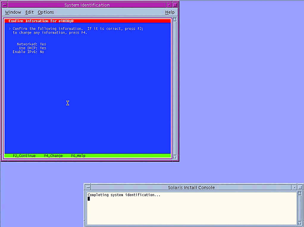

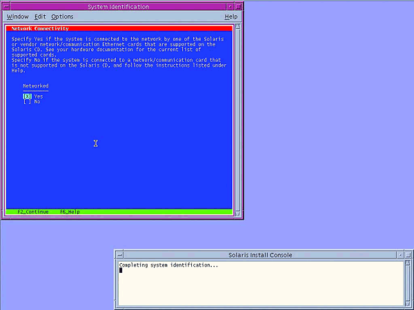

    The Network Connectivity window appears. Use the default answer, (unless you don't have a network) and press [F2] to continue.
    The DHCP selection appears. For most cases, just select DHCP for your network configuration using the arrow keys and the space bar to make the selection and then press [F2] to continue.
    The IPv6 window appears. Just use the default and press [F2] to continue.
    The Confirmation window appears. If you agree with your selections, press [F2] to continue; if not, press [F4] and the process will go back to step 5.

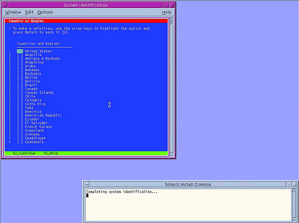

    The Time Zone window appears. Next, set the time zone for the system. This example sets the Americas time zone. Use the arrow keys and the space bar to make the selection, then press [F2] to continue.
    Time Zone cont'd. Set the United States Country & Region, then press [F2] to continue.
    Time Zone cont'd. Set the Pacific Time, then press [F2] to continue.

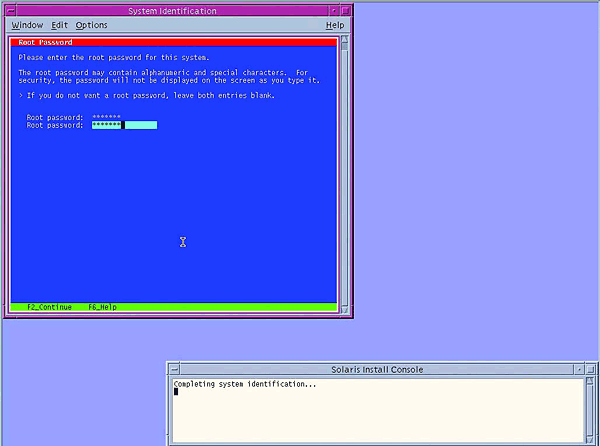

    The Root Password window appears. Set the root password. Note the password typed remains invisible. Re-enter the password in the second box and press [F2] to continue.

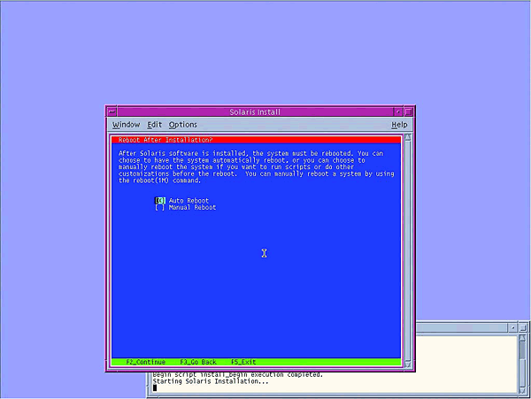

    The Reboot After Installation window appears. Use the default, press [F2] to continue.
    The Confirmation window appears; press [F2] to continue. In some cases, the system will not be able to eject the media after installation. Be sure to eject it manually to avoid starting the installation process again; if after the installation your system didn't eject the media and the install process started again, you can simply reboot your system. During the boot process, eject the media and the system will boot from the hard disk using the freshly installed Solaris 10 image.

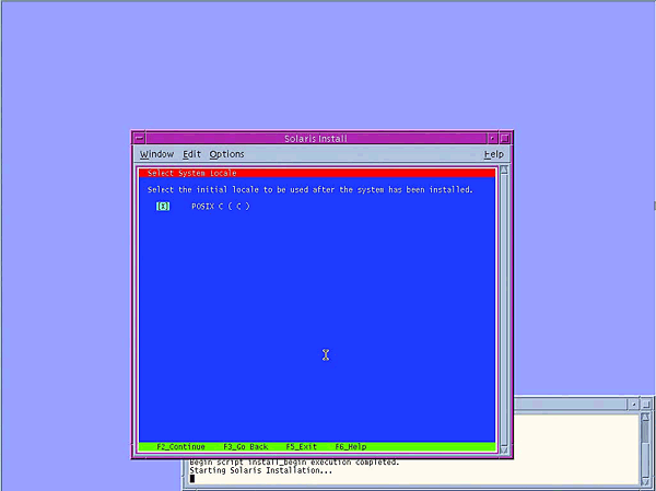

    The System Locale window appears. Press [F2] to continue.

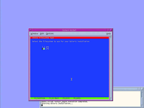

    The Root File System selection window appears. Select ZFS and press [F2] to continue.
