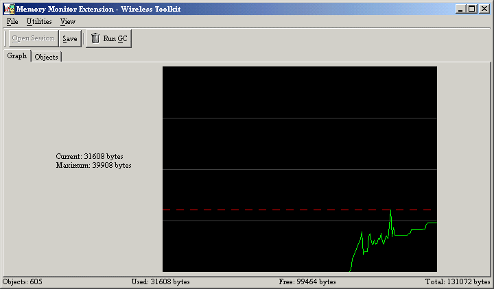

Memory is a critical resource in MIDlets. The toolkit provides a monitor that allows you to scrutinize the memory use of your MIDlet as it runs. To turn on the memory monitor, in KToolbar's menu choose Edit > Preferences. Then click on the Monitoring tab and check Enable Memory Monitor. Click on OK.
Now run the project again. The memory monitor pops up behind the device emulator. It shows a graph of memory use over time. At the bottom of the window is the current count of objects, the number of bytes of memory in use, the number of free bytes, and the total memory.

Your application will run much slower than usual because every object allocation and garbage collection will be monitored.
Click on the Objects tab to see a listing of all the objects your application is using. Each object's type is listed along with the number of live instances, the total number of instances that have been created, the total size in bytes used by the live instances, and the average size used by instances of this type.
The right side of the window shows where instances of this type are created. If you see that a certain type of object is taking up a lot of memory, the right side of the window makes it easy to find out where those objects are being created. The following screen shot shows the memory monitor's view of objects. In this application, 36 MutableImage
