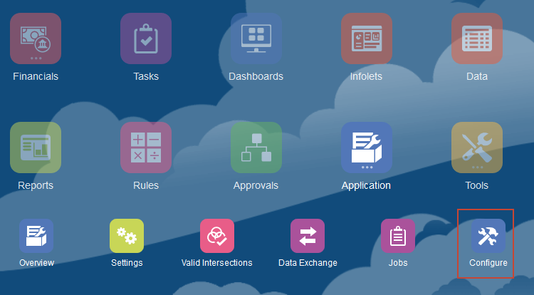

- On the Planning home page, click Application then Configure.
- From the Configure drop-down, select Financials.
- Click Enable Features.

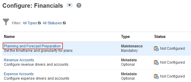

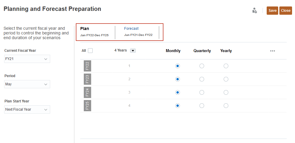

In Planning and Forecast Preparation, you select the current fiscal year, period (month), and plan start year to control the beginning and end duration of your scenarios. You also set the period granularity for the Plan, Forecast, and Rolling Forecast (if enabled) scenarios in your business process.
- On Configure: Financials, click Planning and Forecast Preparation.
Notice the Current Fiscal Year is FY20, the current period is January, and the Plan Start Year is set to Next Fiscal Year.
- Click Forecast.
The Forecast starts in February FY20 and runs through December of FY21. The two year forecast is set on a monthly basis.
- Click Plan.
The four year Plan which runs from January FY21 through December of FY24, has each year's data planned on a monthly basis.
- Click Close.

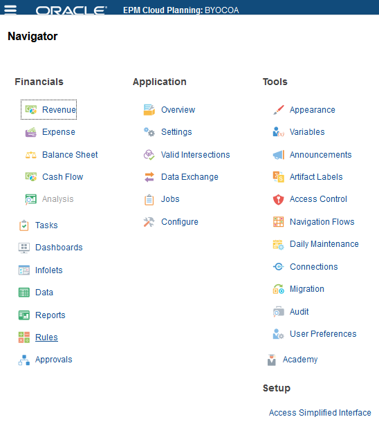

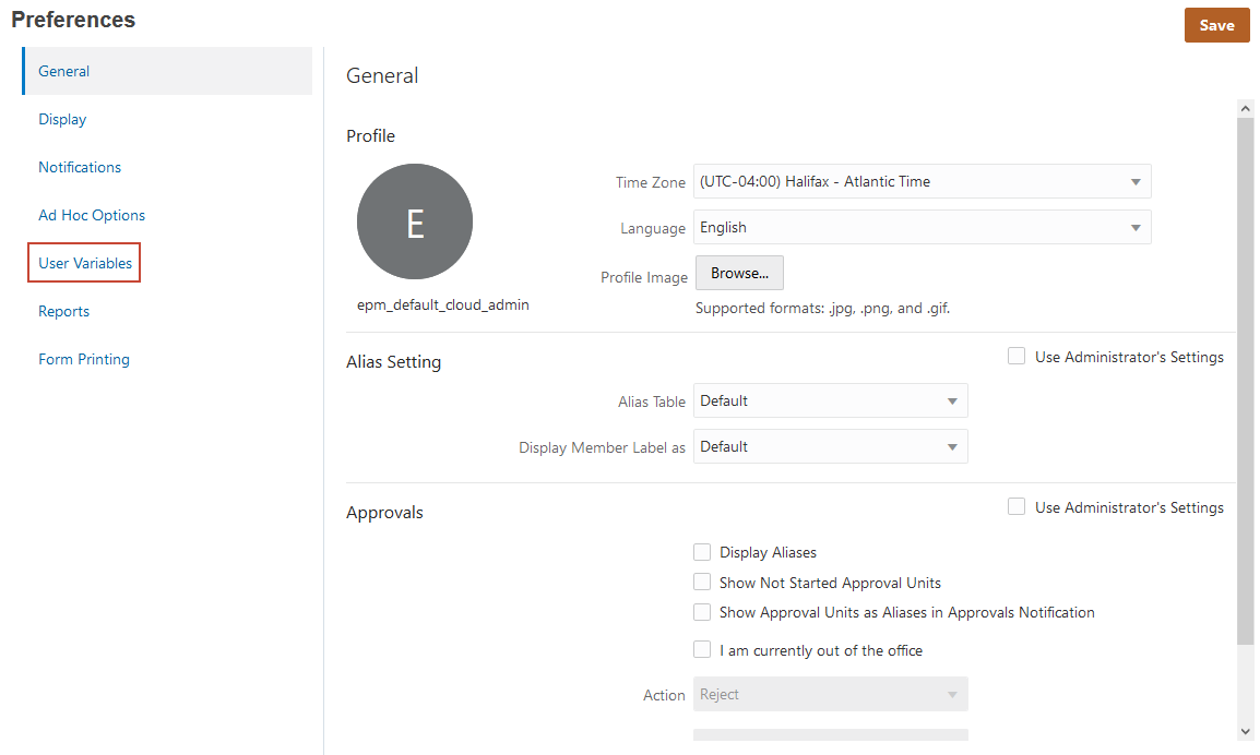

- Click
(Navigator), and under Tools, select User Preferences.
- Click User Variables.
- For each variable click
(Select Member) to set the variable's value as specified below:
- Currency: USD
- Entity: 1 US
- Reporting Currency: USD
- Scenario: OEP_Plan
- Version: OEP_Working
- Years: FY21
- Expense Account: OFS_Operating Expenses
- Expense Drivers:OFS_Travel and Entertainment Expense Drivers
- Click Save.
- At the information message, click OK.

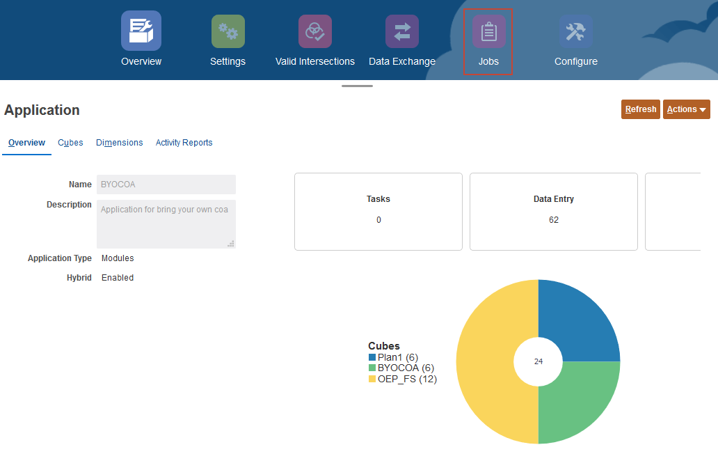

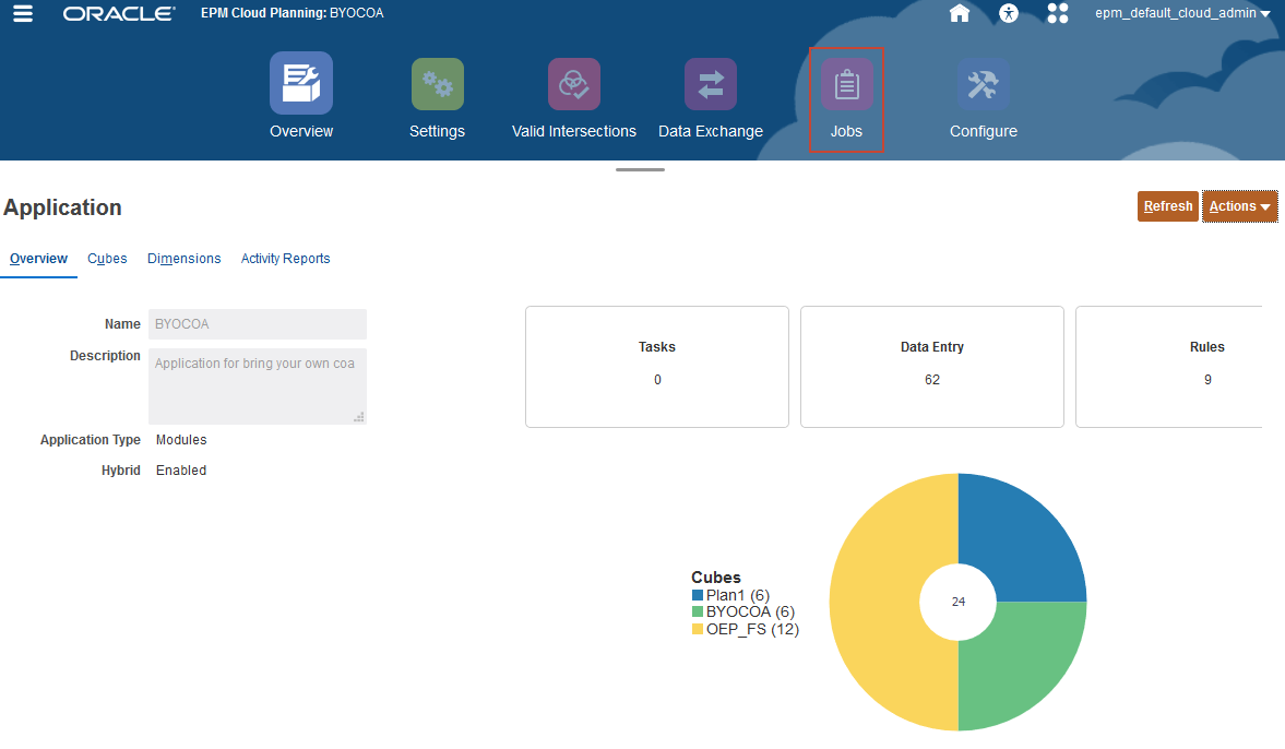

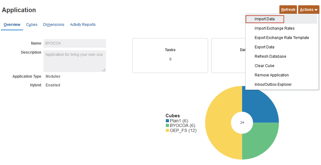

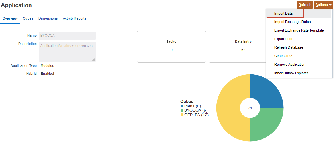

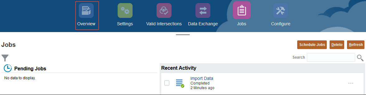

- On the Planning home page, click Application, then Overview.

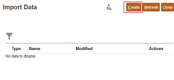

- On the Application page, click Actions, and select Import Data.
- In Import Data, click Create.
- Keep all the default selections, and click Browse to select a file.
Depending on your browser, the button label may display Choose File or Browse.

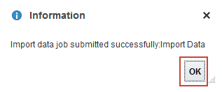

- Locate and select Revenue_Data FY20.csv, and click Open.

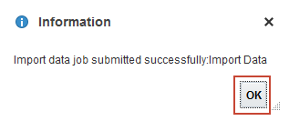

- Click Import.
- At the information dialog, click OK.
- Click Close twice.

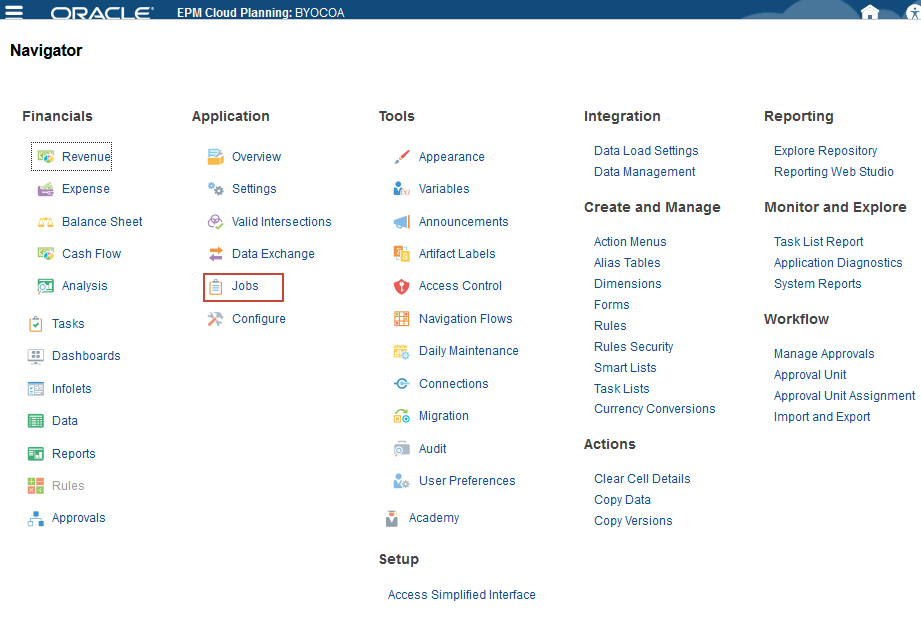

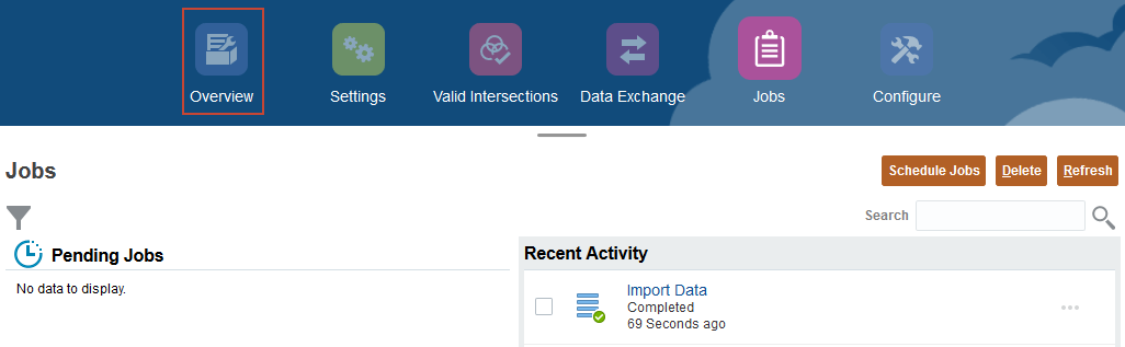

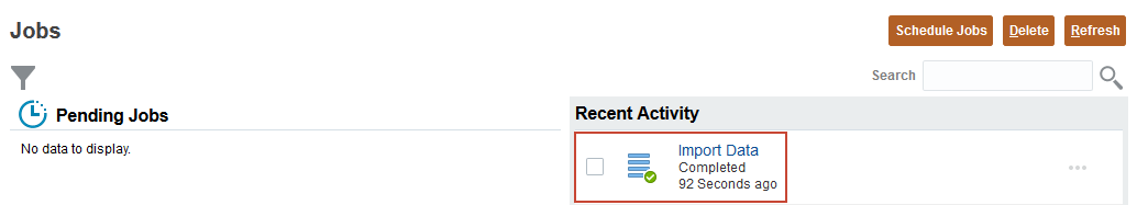

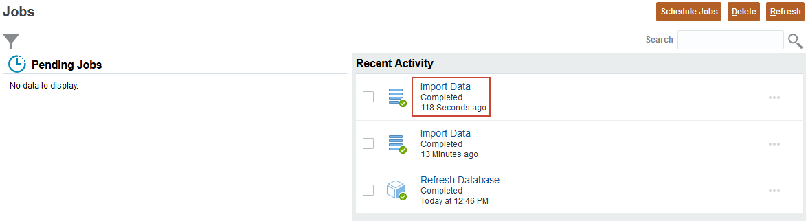

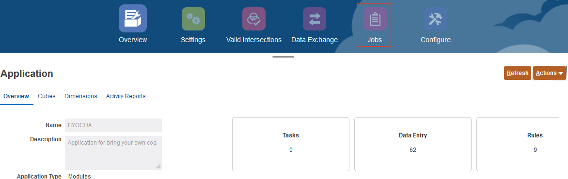

- Click Jobs.
- Verify that the job completed successfully.

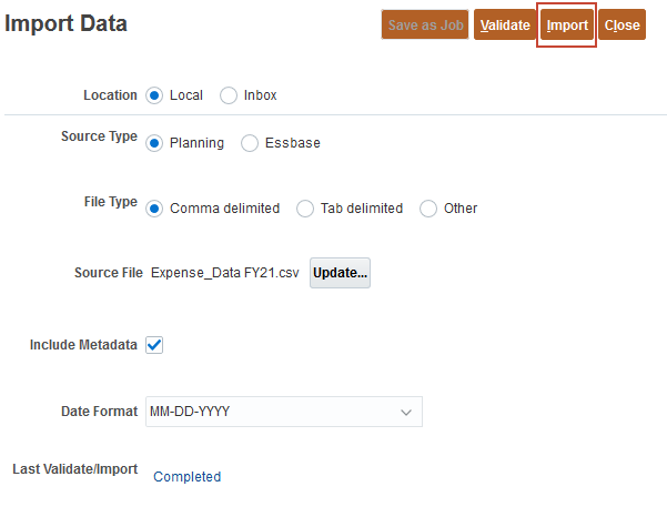

Loading historical expense data
In this section, you load expense data to create a basis for your forecasts.
- Click Overview.

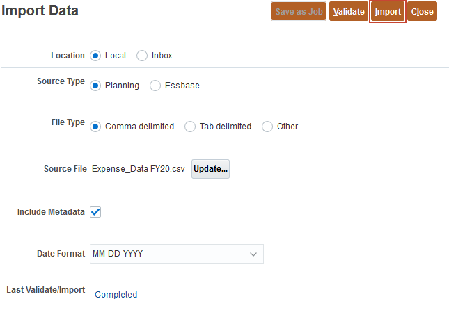

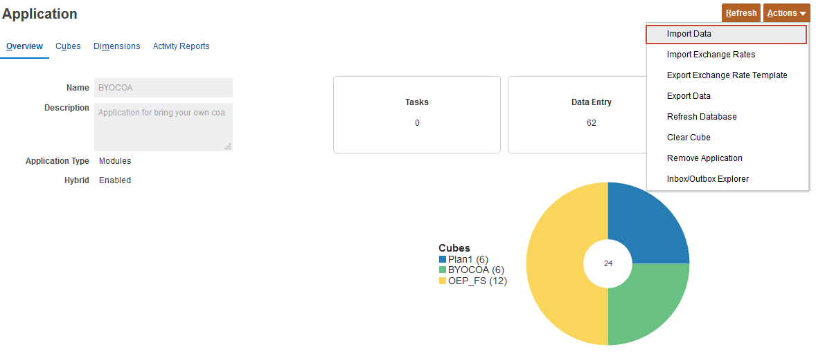

- From the Import Data dialog, click Create.

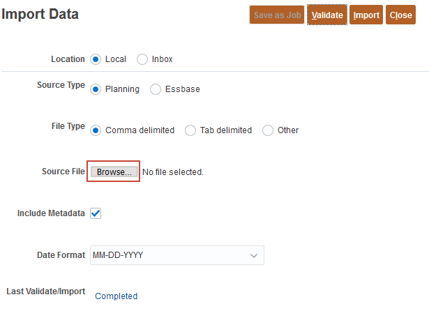

- Locate and select Expense_Data FY20.csv, and click Open.
- Click Import.
- Click Jobs.

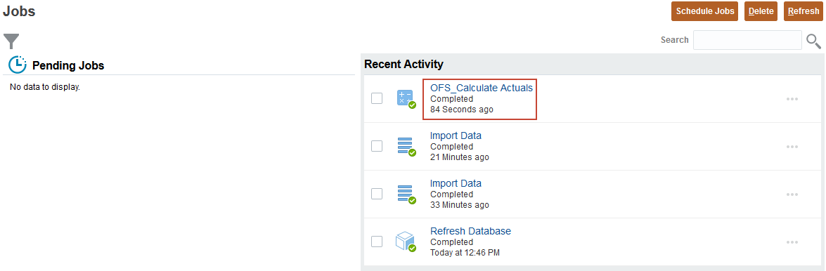

Calculating actuals
In this section, you calculate actual data to roll up the data.

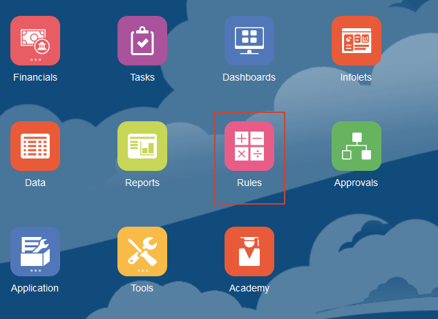

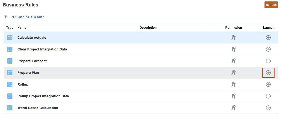

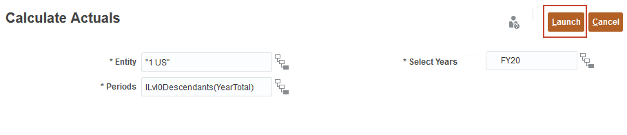

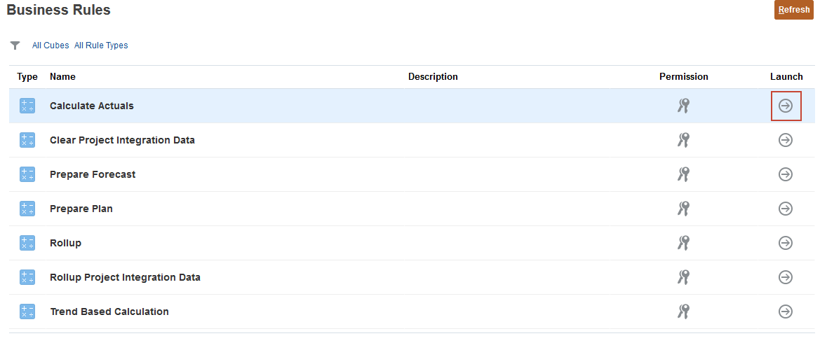

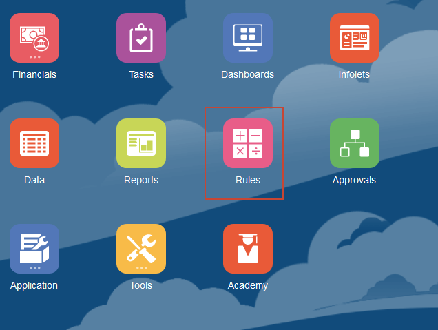

- From the Planning home page, click Rules.
- On Business Rules, for the Calculate Actuals row, click Launch.
- For each item click
(Select Member) to set the member's value as specified below, and then click Launch:
- At the Information dialog, click OK.
- Click
(home).

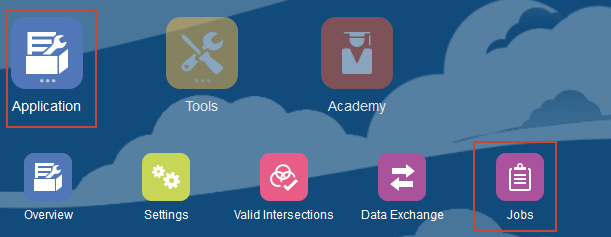

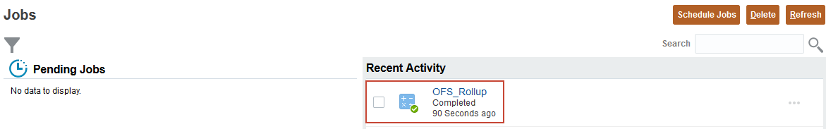

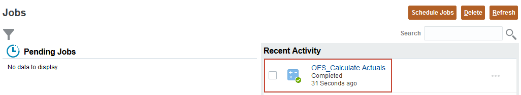

- From the Planning Home page, click Application then Jobs.

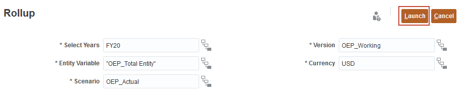

- On the Planning home page, click Rules.
- For Rollup, on the right, click Launch.
- For Scenario, click
(Member Selector) and select OEP_Actual. Then for the year, enter FY20, and for Currency enter USD, and click Launch.
Change the value of the scenario dimension first.

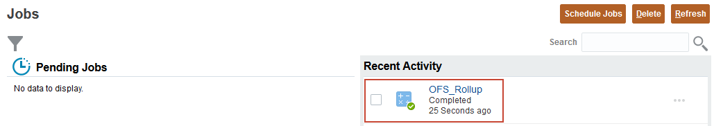

- Click Navigator, and under Application, select Jobs.
The rollup job completed successfully.

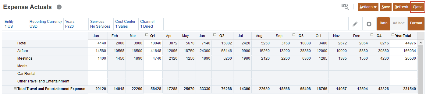

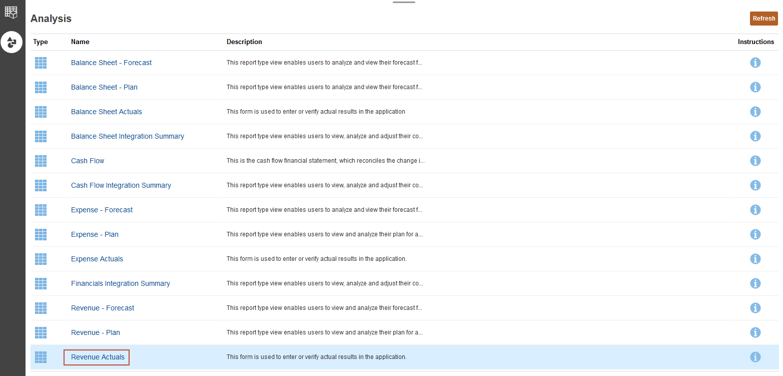

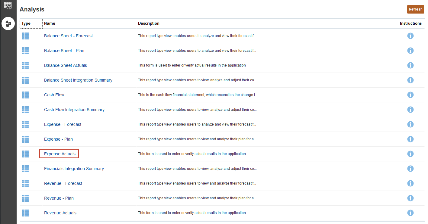

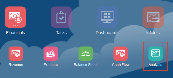

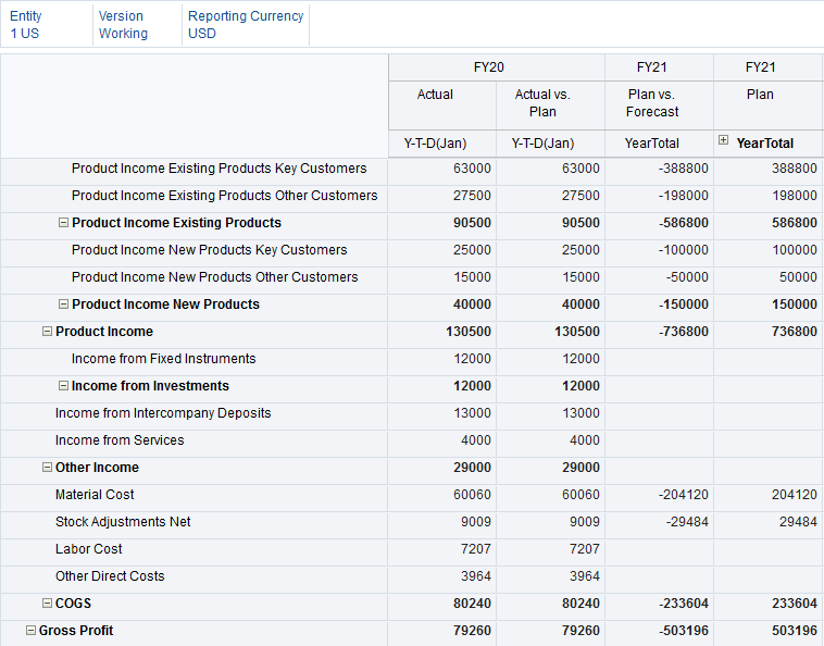

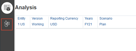

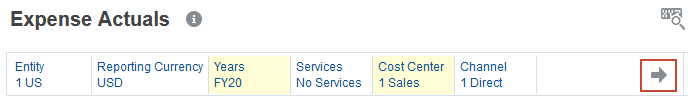

- On the Planning home page, click Financials, then Analysis.
- Select the Forms vertical tab.
- Click Expense Actuals.

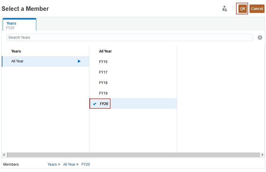

- Click Years, select FY20, and click OK.

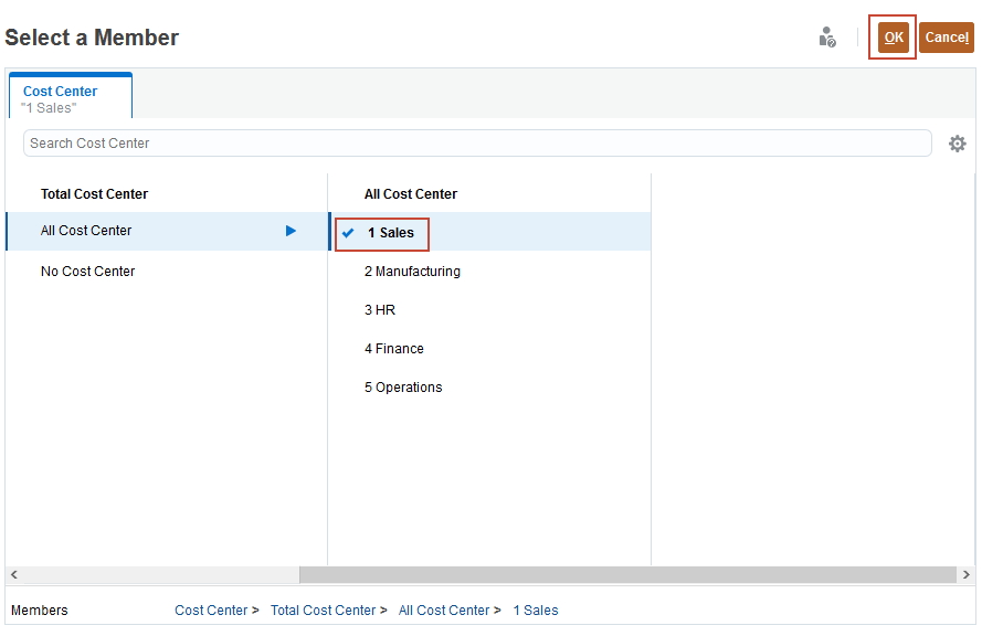

- Click Cost Center, and under All Cost Center, select 1 Sales, and click OK.
- Click
(Go).
The loaded expense data is displayed.
- Click Close.

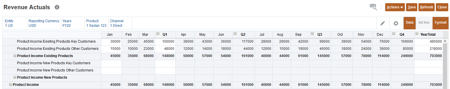

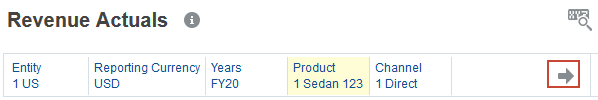

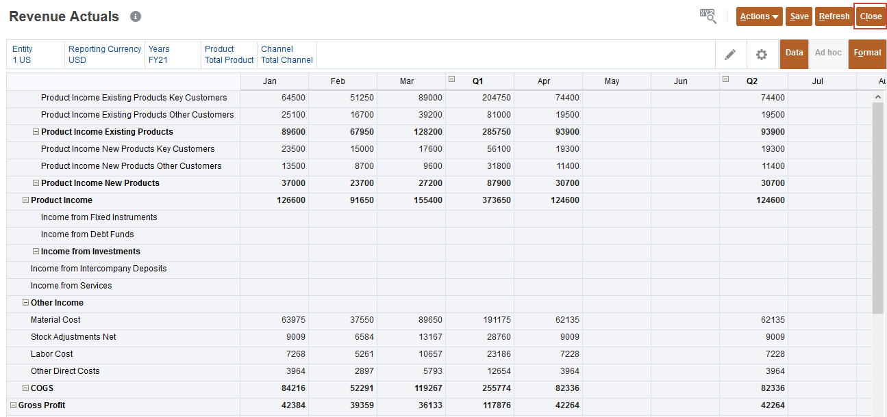

- Click Revenue Actuals.

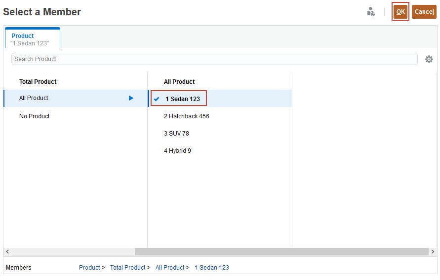

- Click Product, and under All Product, select 1 Sedan 123, and click OK.
- Click
(Go).
The loaded revenue data is displayed.

- Click
(Navigator), and under Financials, click Rules.

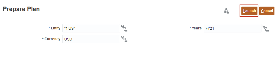

- In the Prepare Plan row, click
(Launch).
- For each item, click its
(Select Member) to select a member as its value, based on the following, and then click Launch:
- Entity: "1 US"
- Currency: USD
- Years: FY21
- At the Information message, click OK.

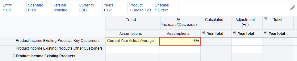

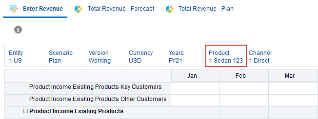

- On the Planning home page, click Financials then Revenue.

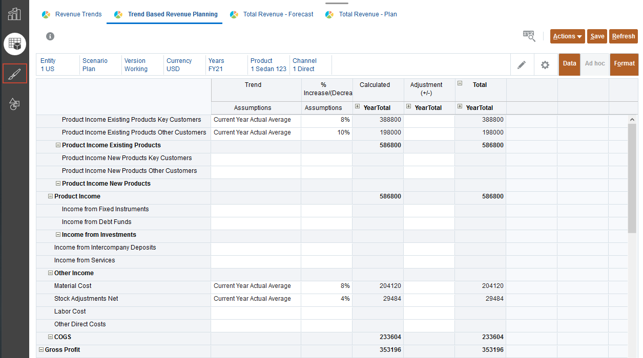

- Ensure you are on the Driver and Trend Based vertical tab, and the Trend Based Revenue Planning horizontal tab.
- Make POV selections based on the following, and click
(Go):

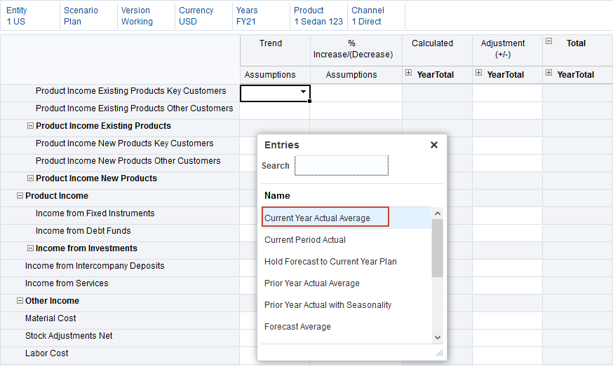

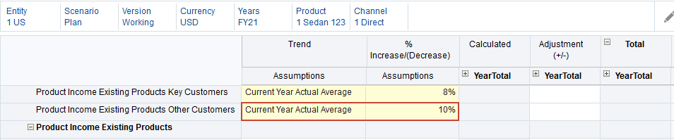

- For Product Income Existing Products Key Customers, in Trend Assumptions, select Current Year Actual Average.
- For Product Income Existing Products Key Customers, in %Increase/(Decrease), enter 8%.
- For Product Income Existing Products Other Customers, in Trend Assumptions, select Current Year Actual Average, and for Product Income Existing Products Other Customers, in %Increase/(Decrease), enter 10%.
- For Material Cost, in Trend Assumptions, select Current Year Actual Average, and in %Increase/(Decrease), enter 8%.
- For Stock Adjustments Net, in Trend Assumptions, select Current Year Actual Average, and for Stock Adjustments Net, in %Increase/(Decrease), enter 4%.
- Click Save.

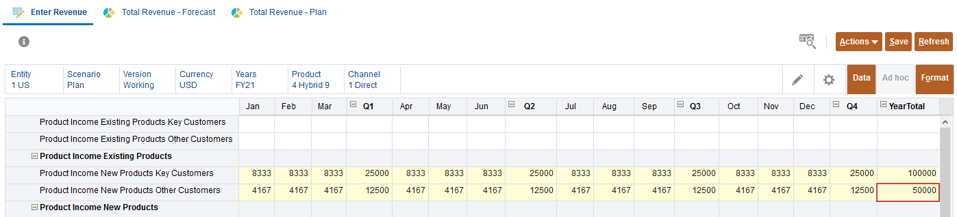

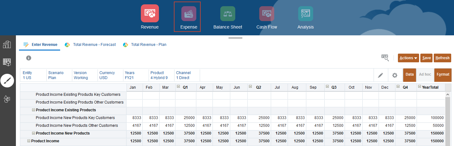

For new products, you can plan using direct entry since there is no historical data available.

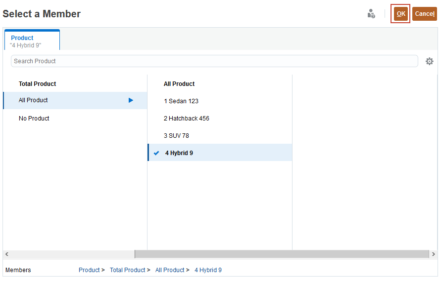

- On the left, click the Direct Entry vertical tab.
- Click Product.
- Under All Product, select 4 Hybrid 9, and click OK.
- Click
(Go).
- For Product Income New Products Key Customers, in YearTotal, enter 100k.
- For Product Income New Products Other Customers, in YearTotal, enter 50k.
- Click Save.

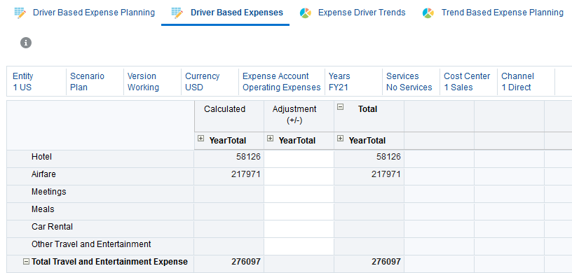

Planning for driver based expenses
In this section you plan expenses with drivers.

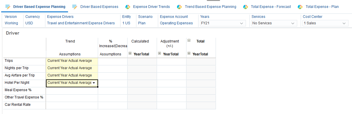

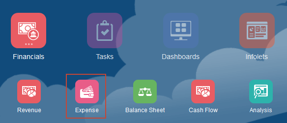

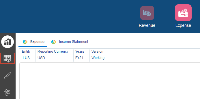

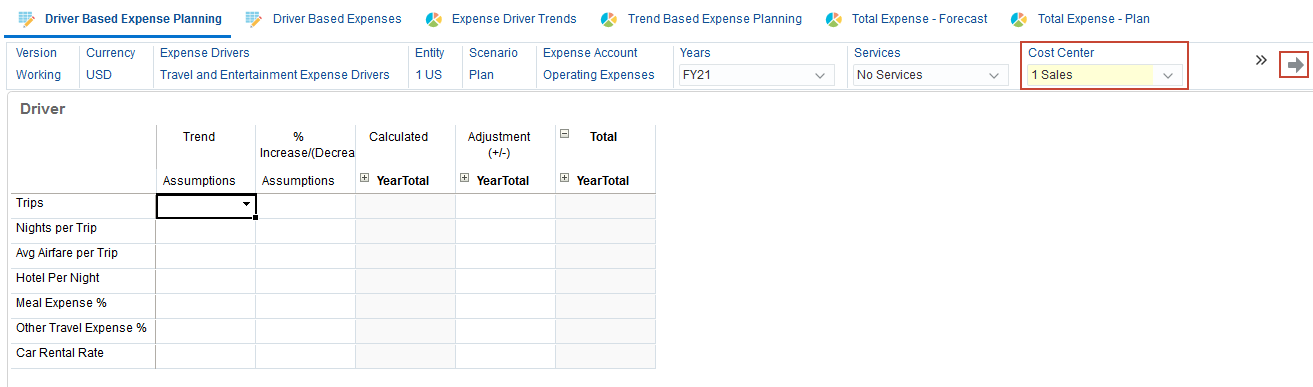

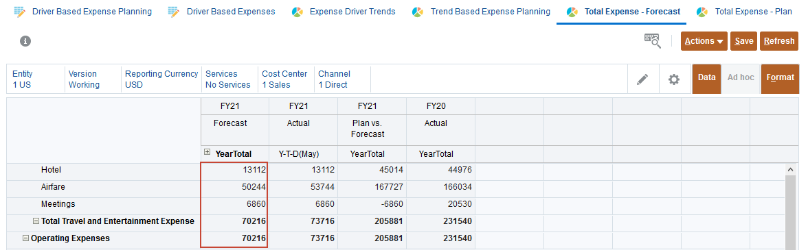

- Click Expense.
- On the left, select the Driver and Trend Based vertical tab.

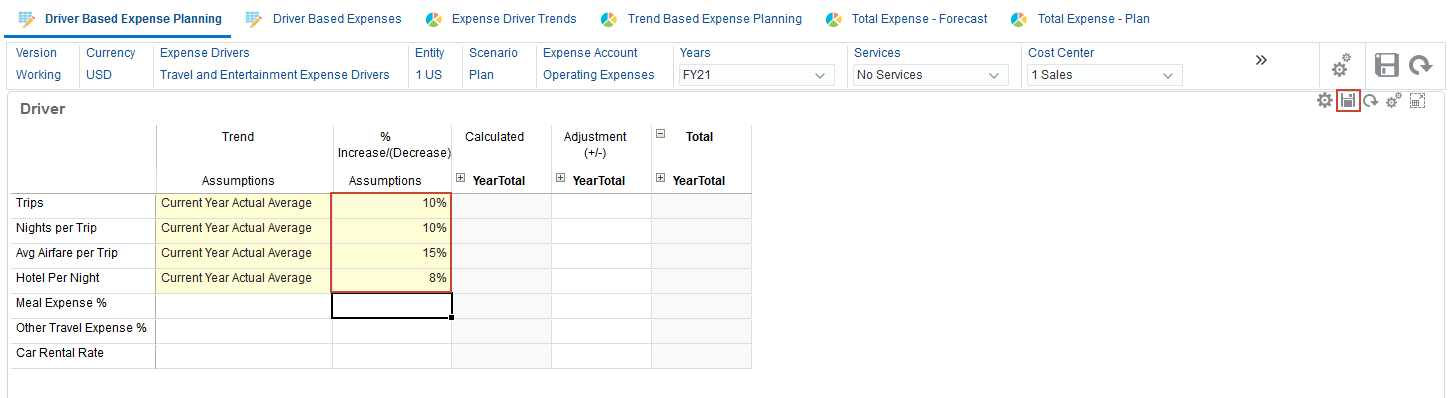

- Notice that Cost Center is in the POV and for Cost Center, select 1 Sales, and click
(Go).

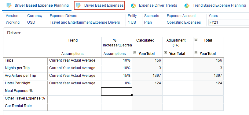

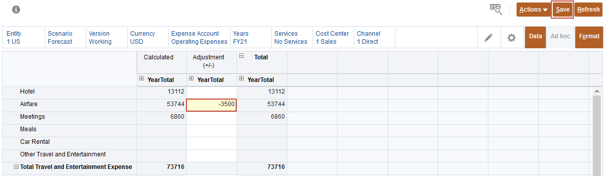

- For Trips, Nights per Trip, Avg Airfare per Trip, and Hotel Per Night, in Trend Assumptions, select Current Year Actual Average.
- For Trips, Nights per Trip, Avg Airfare per Trip, and Hotel Per Night, in %Increase/(Decrease), enter the following:
- Trips: 10%
- Nights per Trip: 10%
- Avg Airfare per Trip: 15%
- Hotel Per Night: 8%
- Click Save.

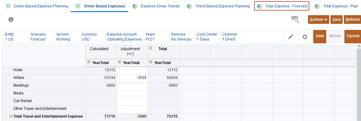

- Click the Driver Based Expenses horizontal tab to verify driver based expenses.
The driver based expenses are displayed.

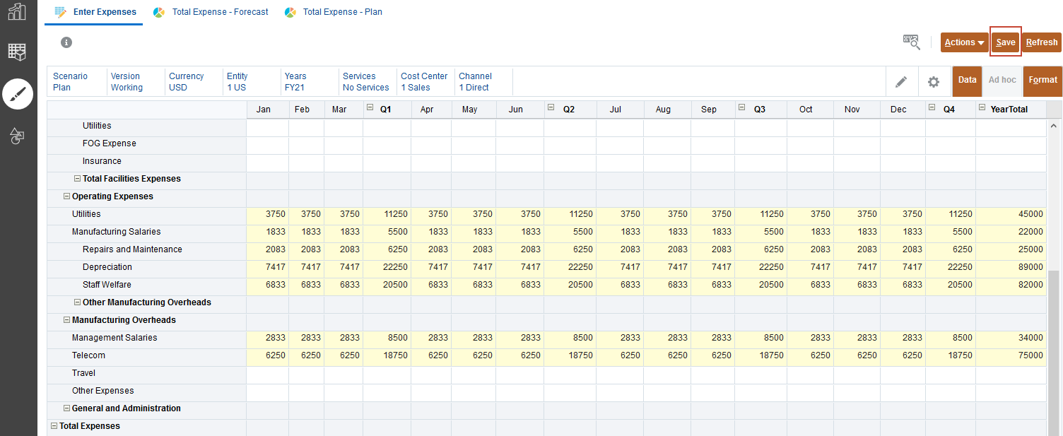

- Scroll down and on the Enter Expenses horizontal tab, in YearTotal, enter the following data:
For Manufacturing Overheads:
- Utilities: 45k
- Manufacturing Salaries: 22k
- Repairs and Maintenance: 25k
- Depreciation: 89k
- Staff Welfare: 82k
For General and Administration:
- Management Salaries: 34k
- Telecom: 75k
- Click Save.

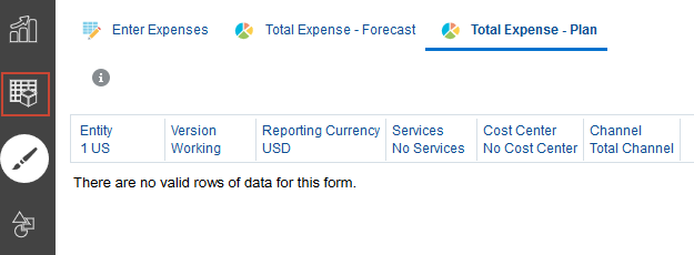

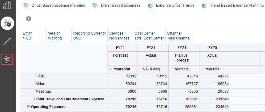

- Click the Total Expense-Plan horizontal tab.

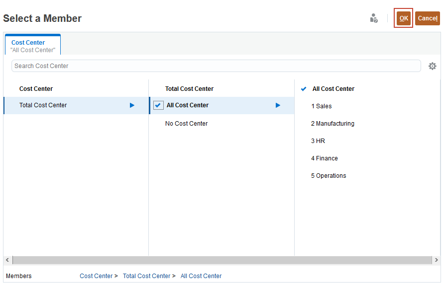

- Click Cost Center, select All Cost Center, and click OK.
- Click
(Go).

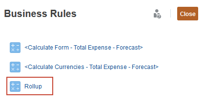

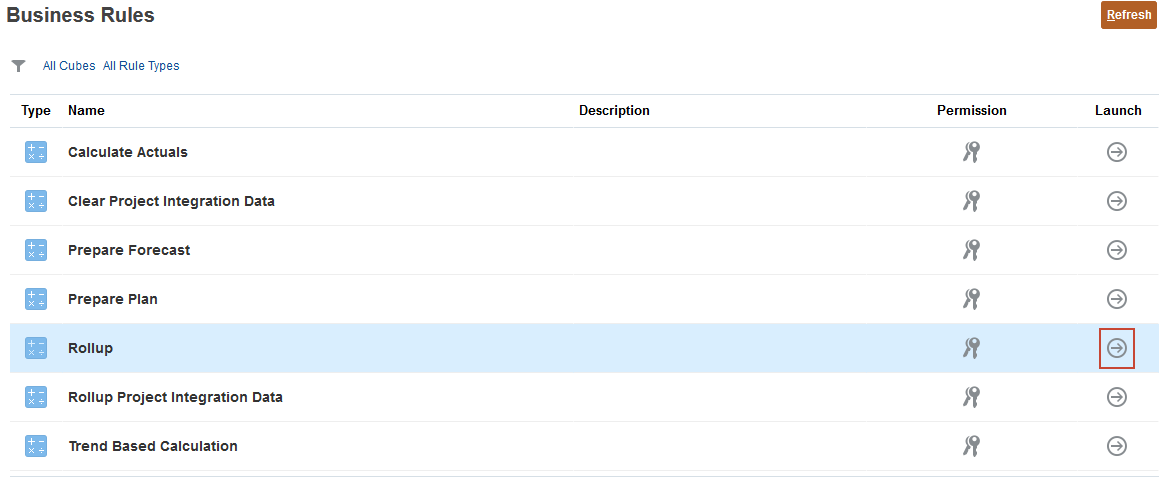

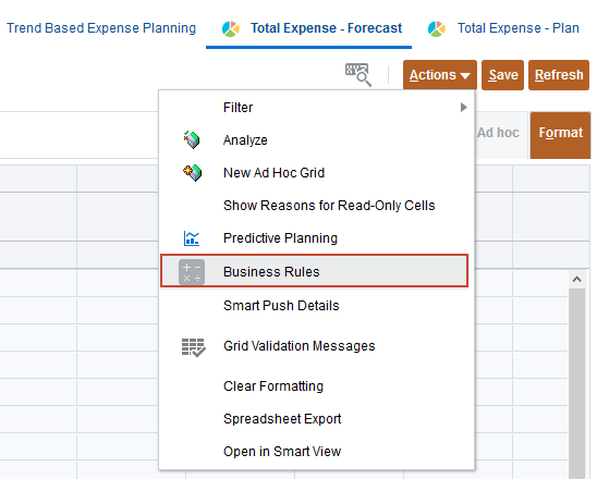

- From Actions, select Business Rules.
- Select Rollup.
- Enter members based on the following, and click Launch:

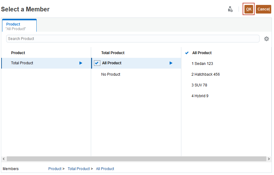

- Click Revenue.
- Click the Total Revenue-Plan horizontal tab.
- Click Product, select All Product, and click OK.
- Click
(Go).
Total Revenue and Gross Profit are calculated for all products.

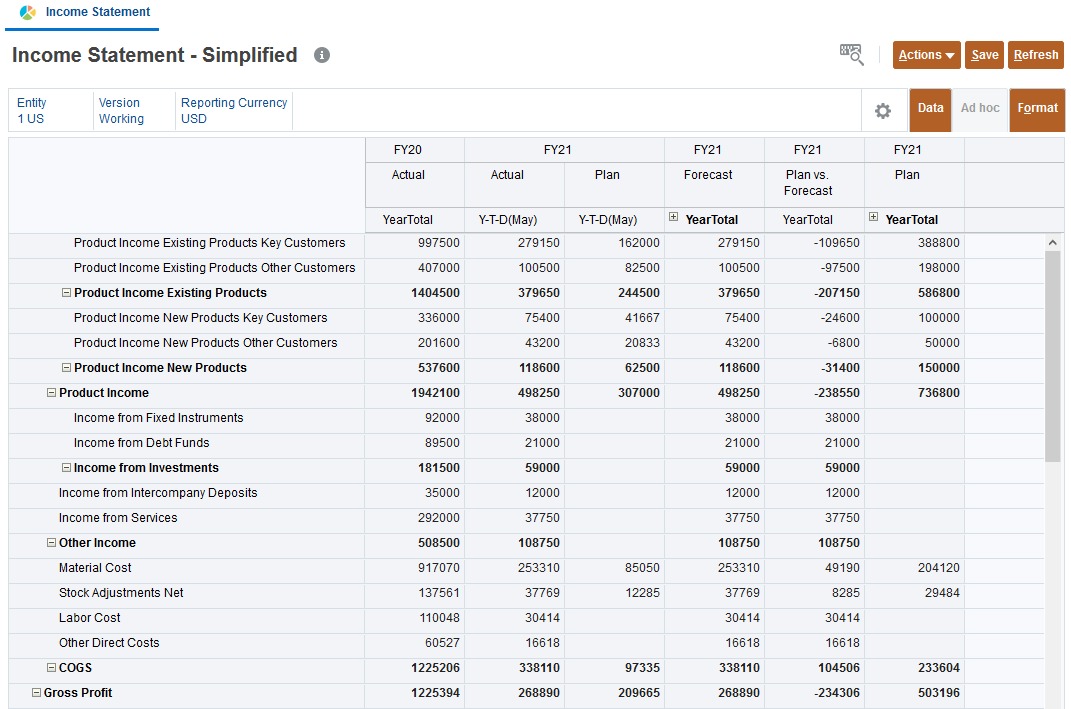

Reviewing financial statements
In this section, you review financial statements to see actual and plan data and variances.
- On the left, click the Income Statement vertical tab.
- Locate and select Revenue_Data FY21.csv, and click Open.
- Click Import.
- Click Jobs.
Loading current actuals for expenses
In this section, you load expense data for the first part of FY21.
- Click Overview.
- Locate and select Expense_Data FY21.csv, and click Open.
- Click Import.
- Click Jobs.
(Launch).
- Entity: "1 US"
- Periods: ILev0Descendants(YearTotal)
- Years: FY21

- On the Planning home page, click Application, then Configure.
- For Current Fiscal Year, select FY21, and for Period, select May, and click Save.
- At the Validation message, click OK.
- Notice the Plan starts in Jan FY22, and Forecast starts in Jun FY21, and click Close.
(Launch).
(Member Selector) and select OEP_Actual. Then for the year, enter FY21, and for Currency enter USD, and click Launch.
- Click
- Ensure you are on the Forms vertical tab, and click Expense Actuals.
- If necessary, change the POV to the following and click
(Go).
- Notice the loaded expense data for January through April, and click Close.
- Change the POV to the following and click
(Go).
- Notice the loaded revenue data for January through April, and click Close.
- On Business Rules, for the Prepare Forecast row, click
(Launch).
- For Entity, Actual Months, Currency, and Years, click
(Member Selector) and select the following members. Then click Launch.

Entering forecast data for expenses
After running Prepare Forecast to copy actual data from January through April to Forecast, you forecast expenses.
- On the Planning home page, click Financials, then Expense.
- Click the Driver and Trend Based vertical tab.
- Ensure you are on the Driver Based Expenses horizontal tab, click Scenario, and select Forecast.
- Ensure the POV has the following selections, and click
(Go):
- For Airfare, in Adjustment, enter -3500, and click Save.
- Click the Total Expense - Forecast horizontal tab.
The adjusted forecast is displayed.

- Click Actions, and select Business Rules.
- Select Rollup.
(Member Selector) and select Forecast. Then enter or select the following and click Launch.

Reviewing updated financial statements
After updating the forecast, review the Income Statement.
- Click the fourth vertical tab, Income Statement.
The updated Income Statement is displayed.
