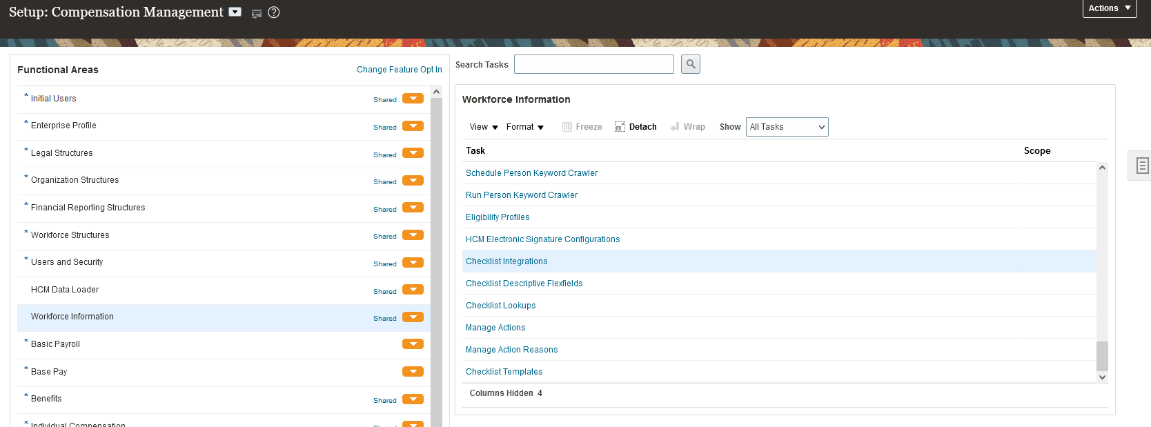

  1. In the Setup and Maintenance work area, select Functional Area Workforce Information
  2. Select the Checklist Integration
    checklist Integrations Selection
    This will open the Configure Checklist Integration page listing any existing integrations configured for HCM Journeys.

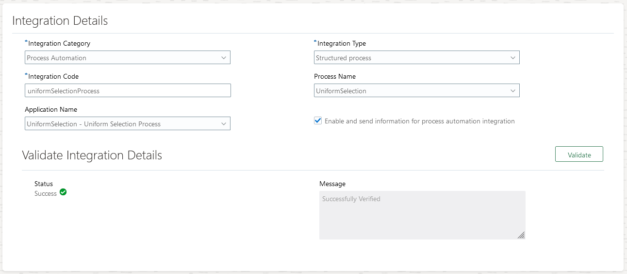

  3. Select Add which will open the Integration Details page.
  4. Enter the values as shown in the table.
    Field Type Value
    Integration Category Drop down Process Automation
    Integration Type Drop down Structure process
    Integration Code Text entry uniformSelection/td>
    Application Name Drop down EmployeeUniformRequest
    Process Name Drop down UniformSelection
  5. Check the Enable and send information for process automation integration
  6. Select Validate
    HCM Journeys will return a status of Success under Validate Integration Details
    validateNewIntegration
  7. Select Save and Close

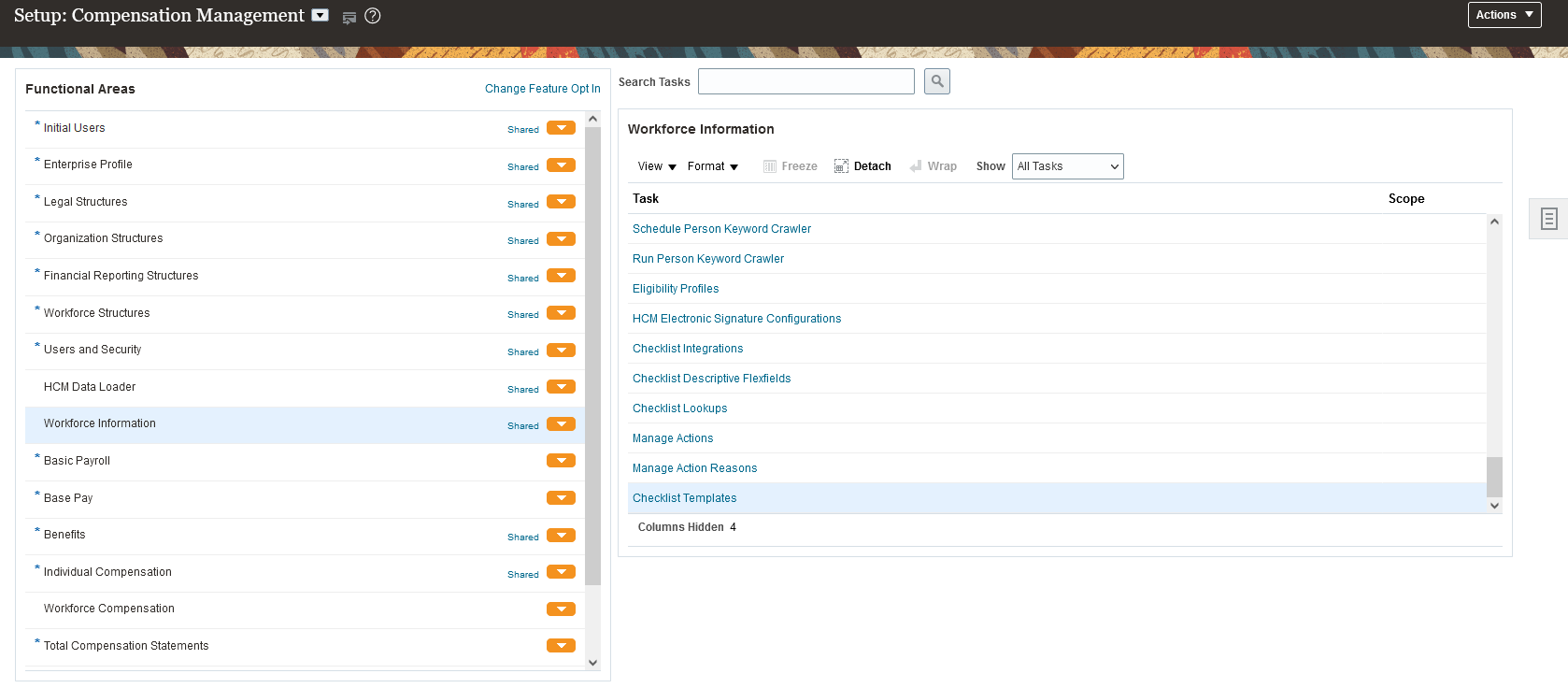

  1. In the Setup and Maintenance work area, go to the following:
    • Functional Area: Workforce Information
    • Task: Checklist Templates
      new Journey Template

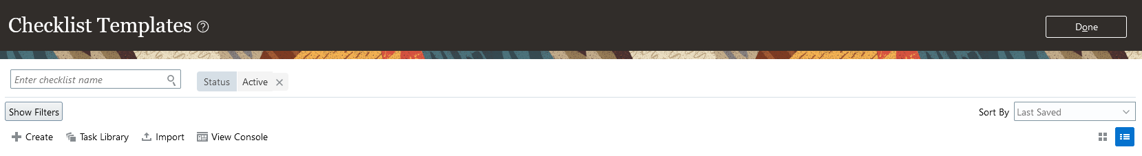

  2. On the Checklist Templates page, click Create to open the Create Checklists page.
    checklist Templates Create

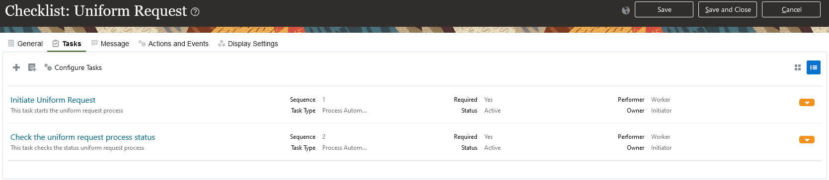

  5. Select Tasks from the menu and then to create a new task.
  6. On the Create Task page, enter the values as shown in the table
    Field Type Value
    Name Text Initiate Uniform Request
    Sequence Text 1
    Description Text This task starts the uniform request process
    Required Check Checked
    Task Type Drop down Process Automation
    Process Section Drop down Process Section 1 – Start Process
    Process Configuration Drop down Employee Uniform Request
    All other values can be left as default.
  8. Next click to create another new task.
  9. On the Create Task page, enter the values as shown in the table
    Field Type Value
    Name Text Check the uniform request process status
    Sequence Text 2
    Description Text This task checks the status uniform request process
    Process Section Drop down Process Section 2 – Check Process Status
  10. complete Jourrney Task Setup
  11. Select Save and Close, returning to the Tasks list for the Checklist Uniform Request Journey template.
