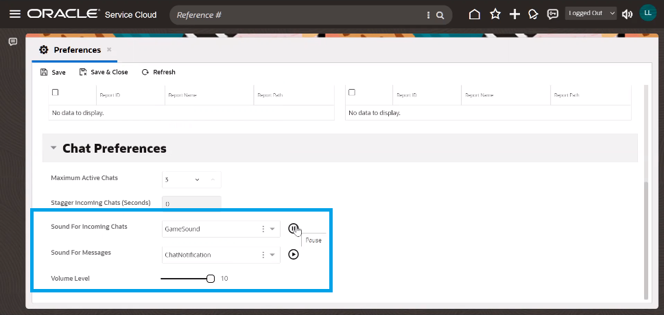

Chat agents can now select different sounds from incoming chats and messages.
In the Preference page, chat agents will have two new options to change sounds.
  • A dropdown to change the sound of incoming chats.
  • A dropdown to change the sound of incoming messages.
The agent can select from 10 seeded sounds. There is a play and pause button to listen to each sound.
Chat Sounds for Incoming Chat and Income Message
Sounds are a way of alerting the agent that a new chat has arrived at the desktop.  This feature will allow the agent to choose the sound that best grabs their attention in order to quicken their response.

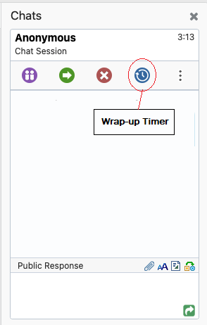

Custom Config for Wrap Up Timer in Chat
The wrap up timer allows the chat agent time at the end of the session with the customer to complete any post-chat tasks on the incident; such as creating an incident, adding the chat to an existing incident, or creating an opportunity from the chat. You can edit this incident in the same manner as any other incident, including changing the incident subject.
By default, the wrap up timer is set to 45 seconds. The amount of time in seconds on the wrap-up timer can be configured for each Interaction Workspace.
Please see Steps to Enable for set up.
Wrap-up Timer on Engagement Panel
Increases efficiency by allocating accurate time needed to wrap-up a chat.

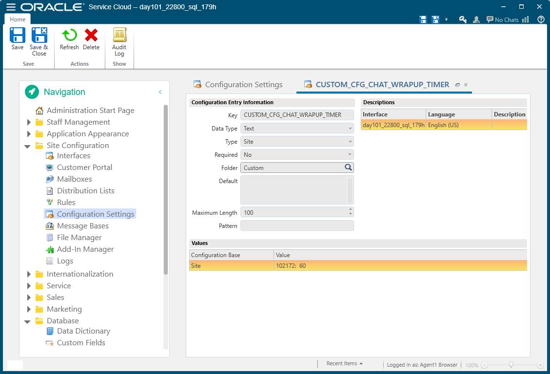

Steps to Enable
  • In the .NET Agent Desktop, open the Configuration Settings from the Navigation Set.
  • From the Ribbon, select New > Text.
  • For Key add: CUSTOM_CFG_CHAT_WRAPUP_TIMER
  • Max Length should be long enough to add all Interaction WS ids and the number of seconds.
  • Value is the Interaction WS ID followed by a colon ":" and then the number of seconds for the wrap-up timer
    • Example: 102172:15
  • The Value field can include multiple entries that are comma-delimited.
    • Example: 102172:15, 102163:30, 10073:20
Configuration Settings in Agent Desktop
Wrap-up Timer Custom Config Set Up

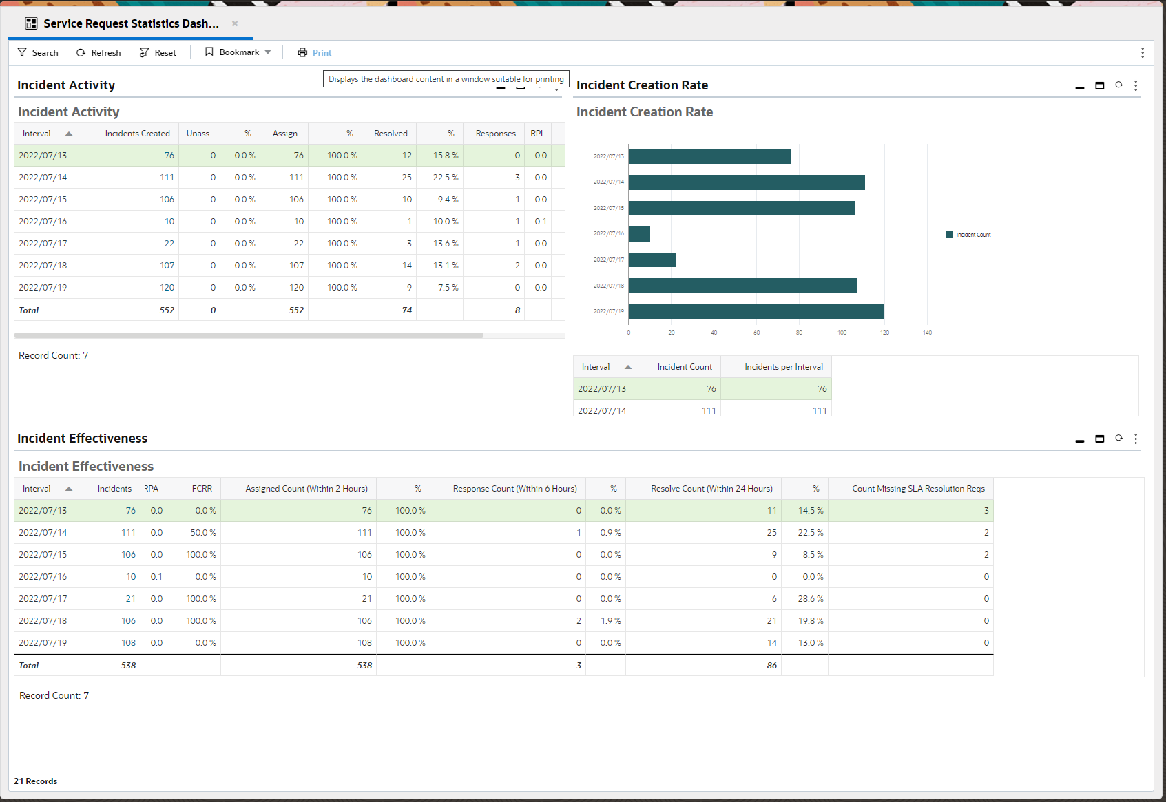

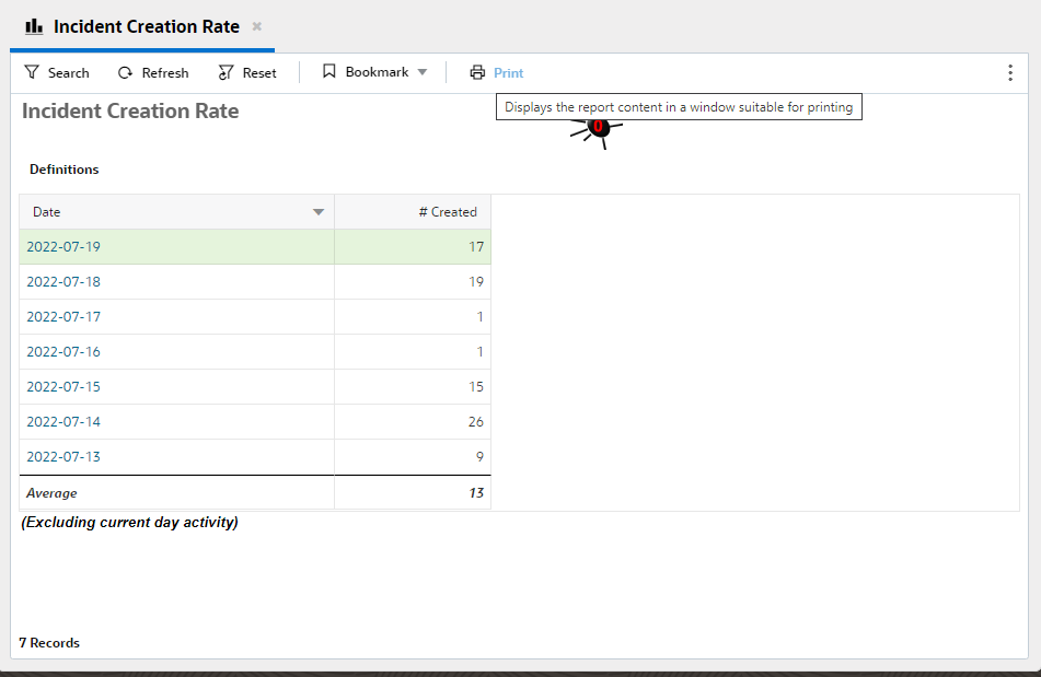

Report and dashboard print capabilities are now available.  The Print action is now accessible via the report or dashboard actions bar.
Location of Print Action on Report Toolbar
Location of Print Action on Dashboard Toolbar

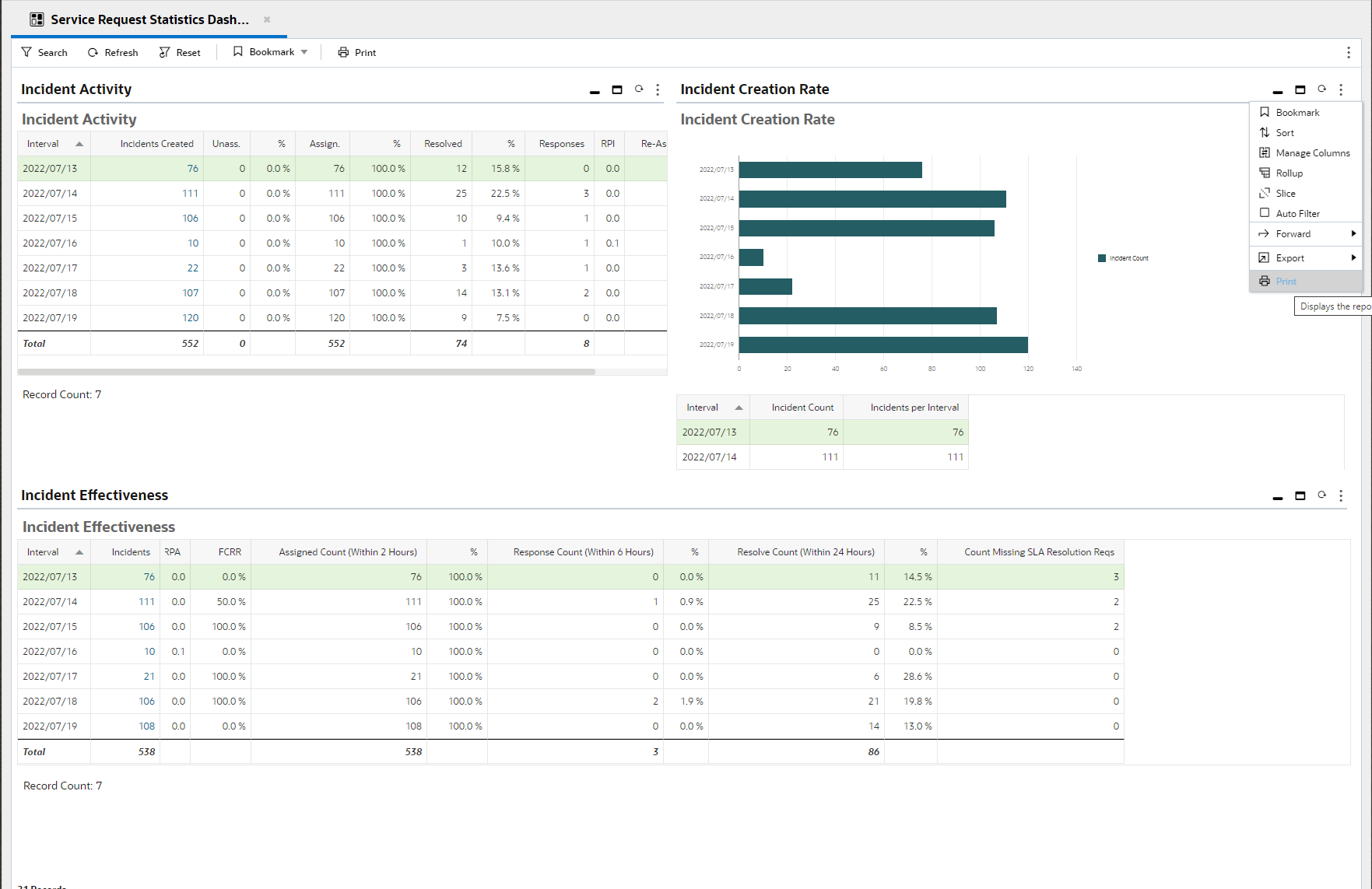

The print function is also available for a single report on a dashboard via each report’s actions menu.
Location of Print Action for Individual Report on a Dashboard
Clicking on a print action will launch a new browser window that will include a printable version of the report or dashboard complete with the header and footer areas.
This will allow the user to print the report or dashboard directly from the application user interface.

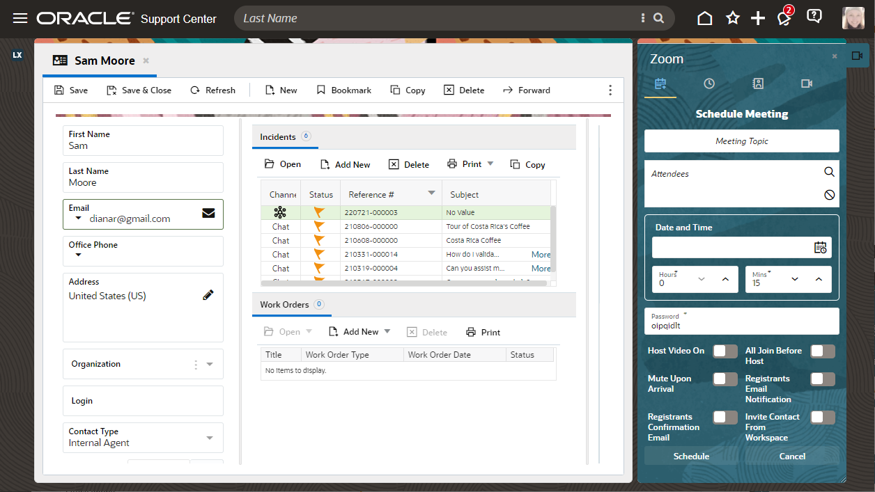

Zoom meetings can now be scheduled, started, and reviewed from Oracle B2C Service Agent Browser.
Please see 'Steps to Enable'
Schedule a meeting
Schedule Meetings
Schedule Meeting Zoom Components
The components with an asterisk will only be supported if they are supported on the Zoom licensing. Each component will be enabled but will not work if the account does not support them.
Supported Zoom Component
Set Meeting Topic
Search and Add Attendees
  • Company contacts, company accounts, Zoom accounts, and direct email address can be added to this text box
Select Date and Time
Enter Duration in Hours and Minutes
Password
  • Default password will generate
  • Password can be updated
  • Password can be deleted
Host Video On*
Allow attendees to join before host*
Mute all attendees*
Send email notification to attendees*
  • Whether to send registrants email notifications about their registration approval, cancellation, or rejection
Send confirmation email to attendees*
  • Whether to send registrants an email confirmation
  • Email confirmation option will only be effective if email notification option is turned on
Invite contact from record
  • If an SR or Contact record is open, the contact will be sent an invitation

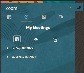

My Meetings
List of My Meetings
My Meetings Zoom Components
Scheduled Meetings
  • Start the meeting
  • Edit the meeting
  • Cancel the meeting
Context Meetings
  • If an SR or Contact record is open, any meetings associated with the record will display in this list.
Archived Meetings
  • Open to copy to clipboard to add meeting details to thread or notes including recording.
Adding a recording to a record
Cloud recordings will need to be enabled in Zoom for recording.
After the meeting complete, the agent can find the recording information in the list of archived meetings. Navigate to the My Meetings tab and click on the sub tab Archive icon at the far right of the panel.  Past meetings and the details will be listed here. Click on the copy to clipboard icon to the right to copy the meeting details and paste to an SR thread or note.
