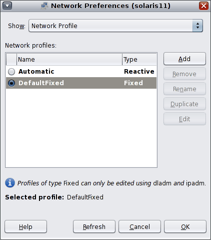

For the Show box in this screen, you can select the Network Profile option. The GUI shows us two network profiles (see Figure 2): Automatic (Reactive Network Configuration) and DefaultFixed (which is outside the control of Reactive Network Configuration). Initially, Oracle Solaris 11 is configured using RNC (through the DHCP service), but we can give up this easy option and instead perform all configuration manually from a terminal window using the dladm and ipadm commands.
Network Profiles
Figure 2 - Network Profiles
If we switch from Automatic to DefaultFixed, a message appears at the bottom of the Network Preferences screen warning us that the manual network configuration must be done using the dladm and ipadm commands, as shown in Figure 3.
Message at Bottom of Network Profiles Screen
Figure 3 - Message at Bottom of Network Preferences Screen

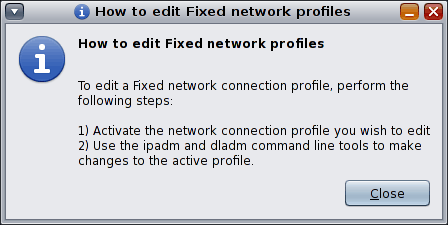

Figure 5 shows the next screen: "How to edit Fixed network profiles."
How to Edit Fixed Network Profiles
Figure 5 - How to Edit Fixed Network Profiles

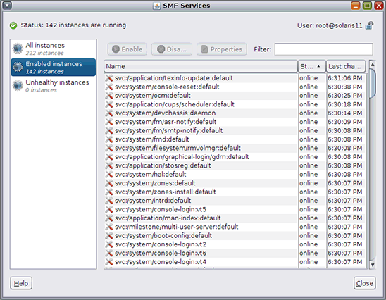

If you don't like using the service commands, that's OK. You can use a great GUI service tool introduced in Oracle Solaris 11 (see Figure 6). You can find it by selecting System -> Administration -> SMF Services. There, you can execute the same tasks that you've performed using the command-line interface.
Managing SMF Services Through A GUI
Figure 6 - Managing SMF Services Through the GUI

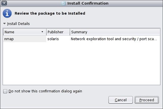

We found the nmap package. Next, let's install it. To do that, first ensure the checkbox next to the nmap package is selected. Then click the Install/Update button. The screen shown in Figure 10 appears.
After Clicking the Install/Update Button
Figure 10 - After Clicking the Install Update Button

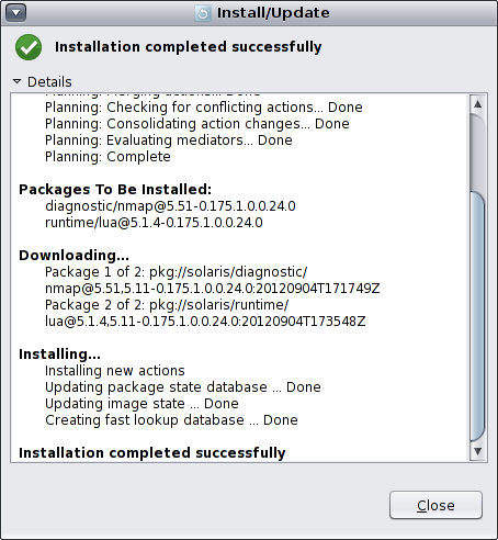

If you are happy with your choice, click Proceed. The package is downloaded and installed, as shown in Figure 11.
Package Downloaded and Installed
Figure 11 - The Package Has Been Downloaded and Installed
Our nmap package was installed successfully, as shown in Figure 12:
Installment Successful
Figure 12 - Message Confirming Successful Installation
